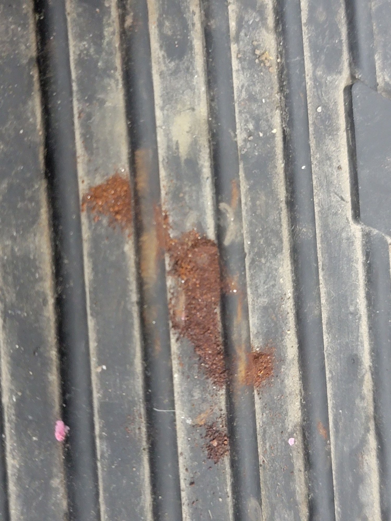

It appeared to have been fine rust particulates. No paint that I could see. My guess is that this was the result of long periods of non-use. We bought the boat, an '02 model, in 2020, with only 143 hours on the meter. That works out to about 7hrs/yr. I think the fuel had been allowed to collect moisture for long periods of time, leading to the rust particles in the fuel rail and injectors. I worry about how much might still be in the tank, and have thought about having the tank pumped and scoped, but have yet to take that initiative.

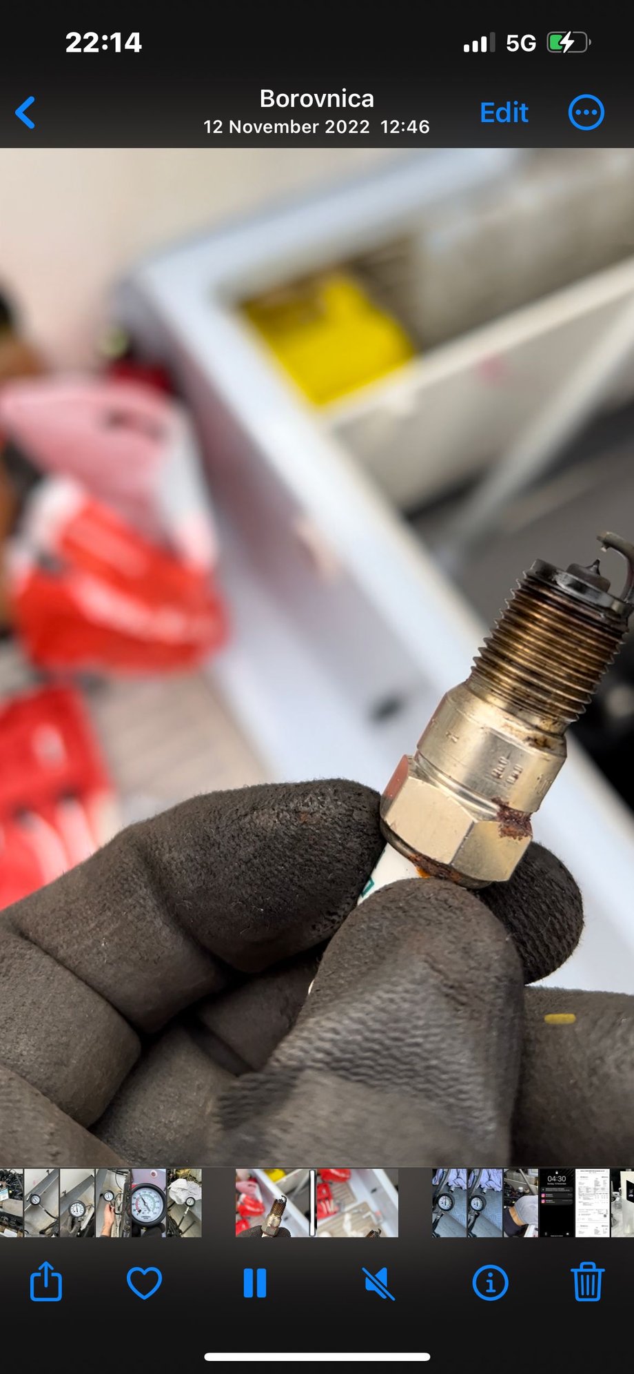

When you changed plugs, what did the old plugs look like?

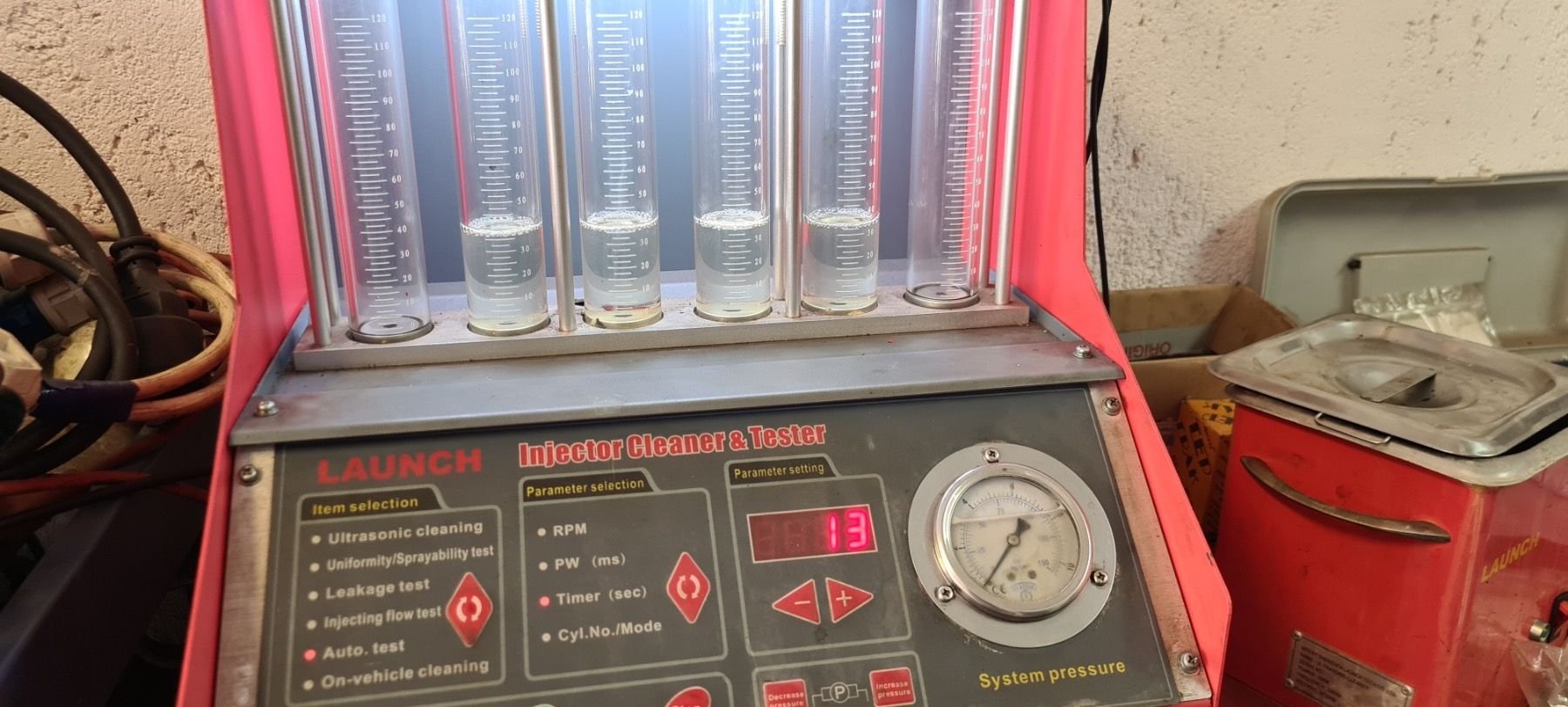

One more.... How did you test the injectors?

we tested the injectors on the injector cleaner and tester it showed that all the injectors are spraying equal. I got all the pictures and videos of the work they did.
All of 8 injectors had the same results.
The only one weird spark plug to me was this one!
Yes like you said I think there is also a smell of gas behind me when i go a little bit faster but I can not smell it. Regarding the ECM there is no sign that it was tuned or something. That can be an easy test if I get one ECM from other engine and test it I will try to get it from someone… I was looking for TechMate here in Slovenia but it is not an easy job to get it. I am on the boat only for weekends so I will send you a video on the weekend…
I have one more thing on my mind. I installed this spark plugs in could be that they are not okay? NGK TR 55 V POWER

Here is the spark plug I went to the spare parts shop with the old sparks and I got this ones so don’t kill me if this are not correct
