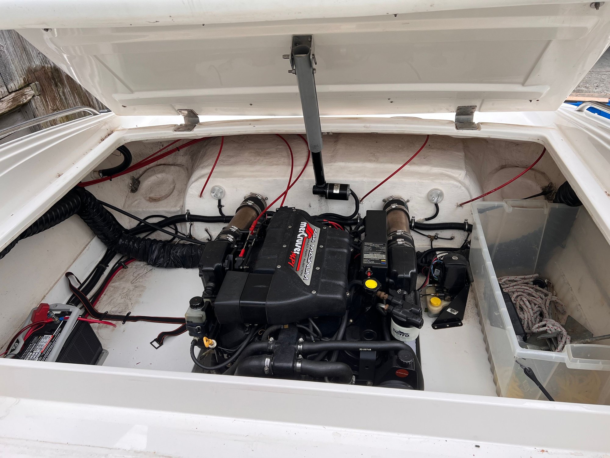

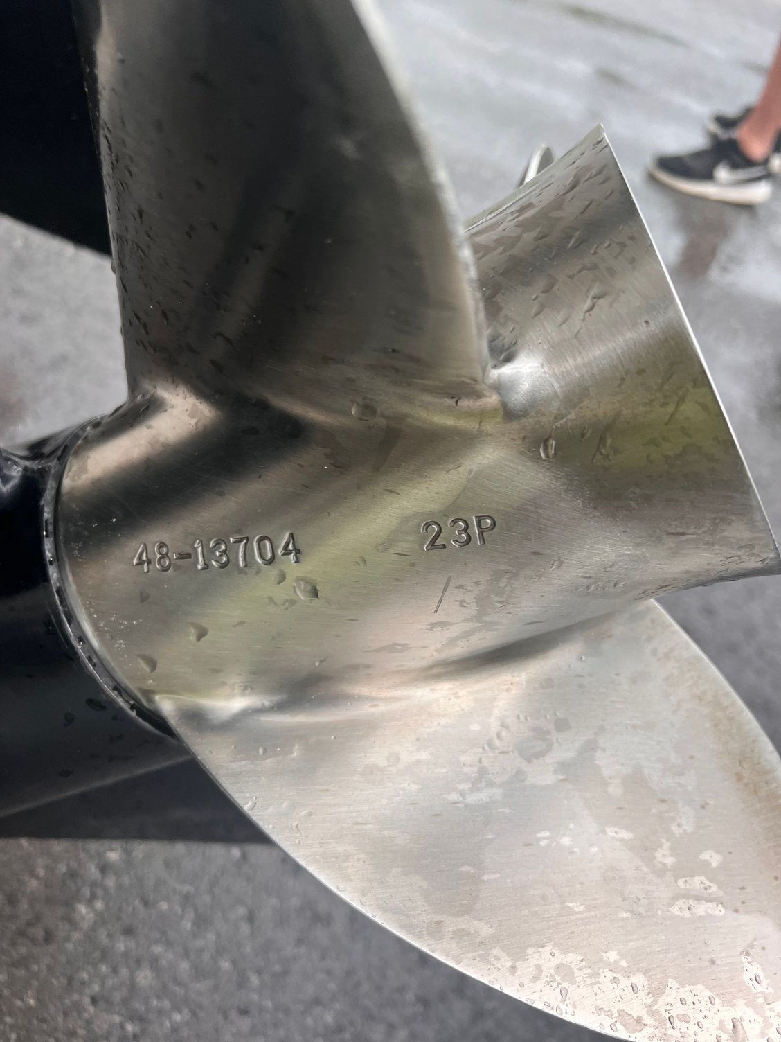

Default Prop and engine
Thanks for the reply.
Does this help?
Do you need anymore info?
Thanks again.

That motor is 385 HP. The Mirage+ prop may or may not be the prop for that boat. I had a 24 Superboat with the same motor. The boat was smaller and lighter but I was turning a 25P Mirage+ to 5000 RPMs. However, the prop caused chine walk and would lose bite in rough water. I switched to a 26P bravo 4 blade with great results. The boat ran in the low 70's.
My suggestions would be to verify that your motor is making the power it should be by getting at least a compression check. Also, try some different props.

I would try a 22" Bravo 4 blade prop or something very similar.
