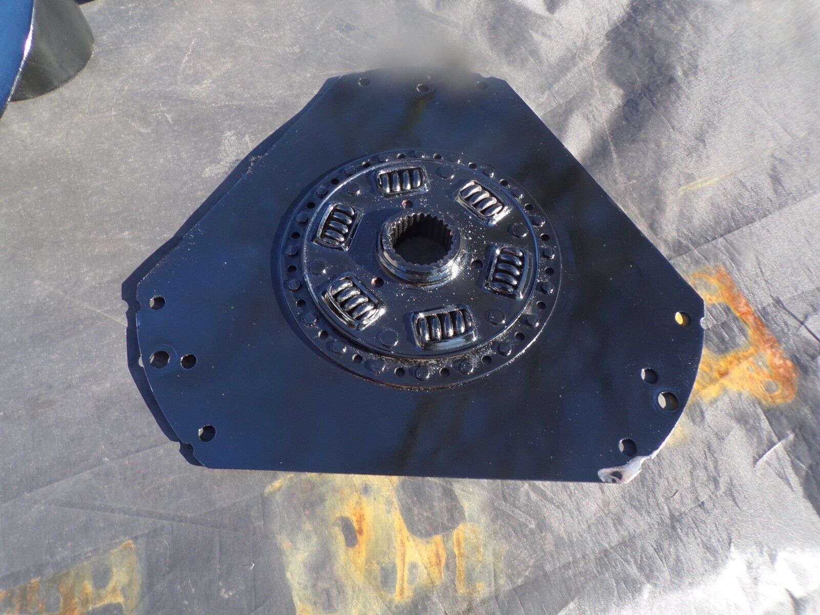

Old 09-20-2023 | 03:45 PM
F-2 Speedy's Avatar
Posts: 11,438
Likes: 3,967
From: Midwest & T-Rock
it might look something like this, bolts to the rear of the flywheel, look through the hole where the drive shaft come out of to the rear of the engine

Old 09-20-2023 | 03:50 PM
Joined: Sep 2023
Posts: 19
This is what mine looks like

Old 09-20-2023 | 04:17 PM
F-2 Speedy's Avatar
Posts: 11,438
Likes: 3,967
ok, sorry thats not like a Bravo 1 never mind
