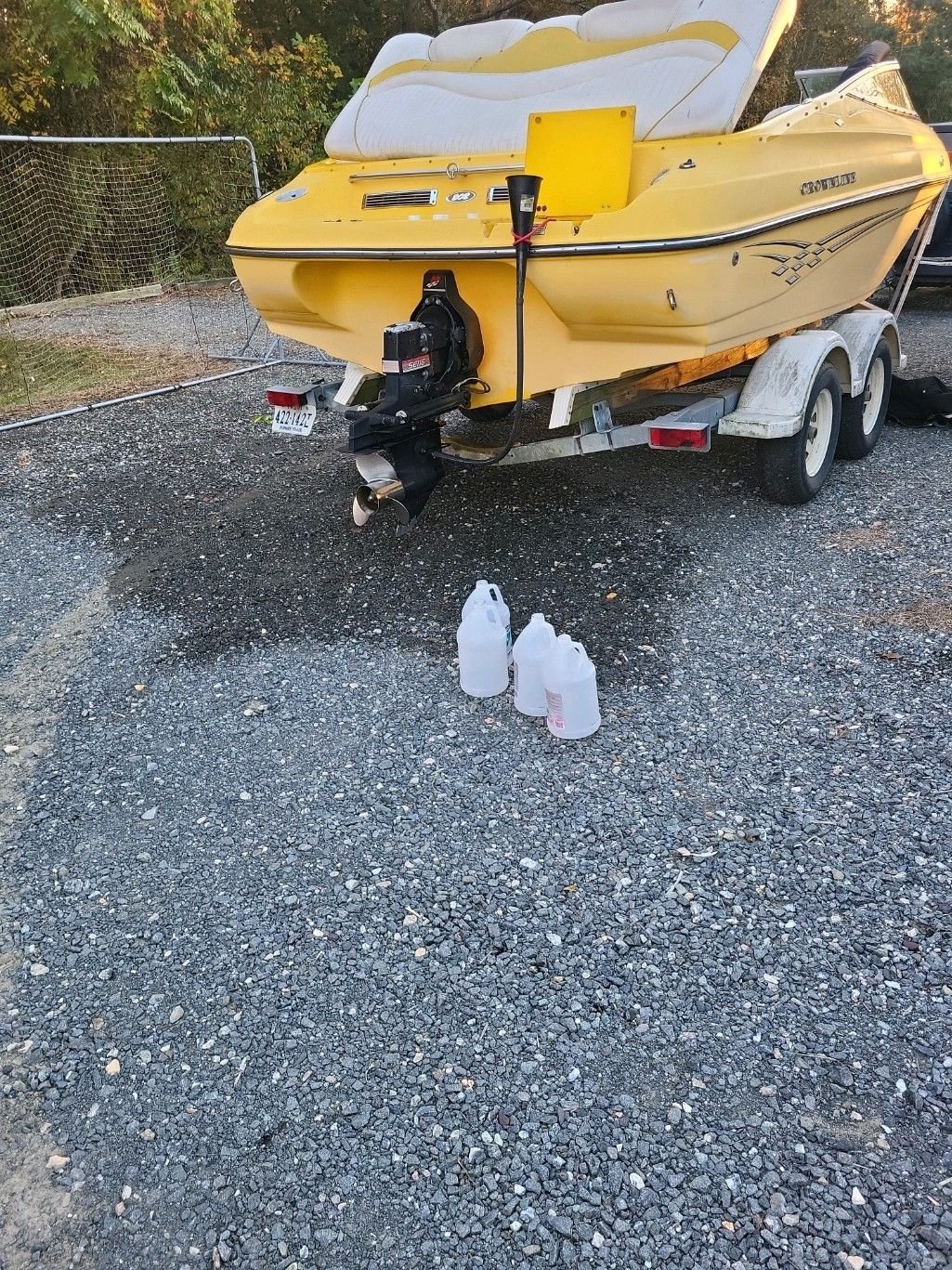

Here in Virginia - it can be 100 in June/July and 0 in Jan/Feb.
Winterized two this weekend. On our little bowrider I use the muffs and a funnel. My wife stands outside and pours while I work the key and the fogging spray. When she's pouring the last gallon, I'll fog it and shut it down. This is a Merc 5.0 that has a "one point drain." I had never seen this setup until we got this boat. It has one valve located at the lowest point and all drains are connected to it. Simple turn of the knob is supposed to drain everything. I don't trust it though, I envision a chunk of coolant passage corrosion or a pebble from the river bottom blocking one, that's why I antifreeze it first.
The Checkmate I use the fresh water flush to pour antifreeze in, and again, fog it on the last gallon. Then I'll pull hoses and plugs to drain the block, pumps and exhaust.
I took the photo below because my dad and brother sent me a text of them out on the river in his pontoon this weekend. I sent this back as to say FU
