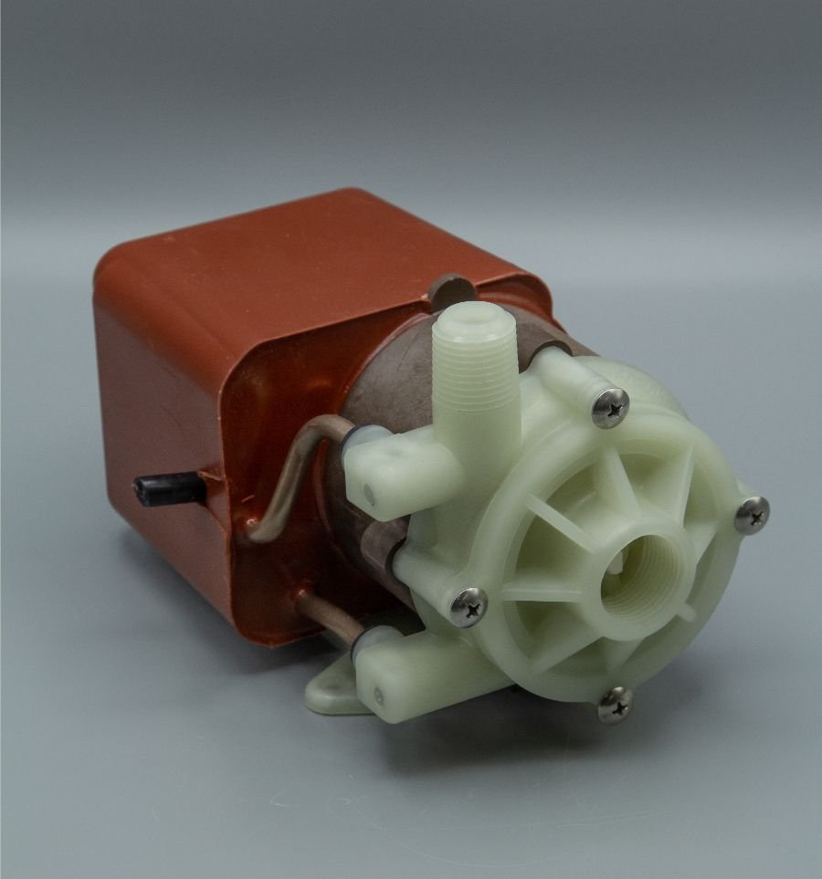

If anyone is doing winterizing on their A/C systems and has one of these pumps like the picture, make sure to actually run the pump and not just force feed antifreeze through the system with an outside pump or air pressure. I get calls in the spring with boaters asking why there's water pissing out the side of the pump. That copper tubing you see on the side is actually one long tube about 3' in length before it gets wrapped around the motor. If all you do is force feed the system you get antifreeze in the pump head but not in the cooling lines. The antifreeze will get diluted right where it meets the cooling tubes from the raw water that's in the tube and it will pop the plugs out of the plastic housing and next time you put water through it, it will be filling the boat up slowly.
