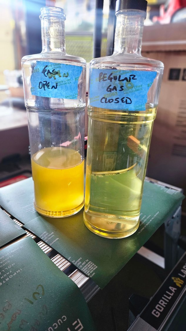

Completely unscientific but here it is for what it`s worth,
I took 25% ethanol gasoline out of the boat 10 months ago and treated it with amsoil and Stabil 360.
(2) Stabil360 bottles , one open to atmosphere, one closed
(2) Amsoil fuel stabilizer (dark in color) one bottle open , one closed.
(1) 25% ethanol left open (non treated)
(1) 25% ethanol bottle closed to atmosphere. (non treated)
After 10 months the open 25% non treated get cloudy when stirred and I can maybe see some seperation... doesn`t seem to burn as well as the others.
The rest open or closed I do not see any difference since 10 months ago .
Video of both untreated, one closed (still looks fine) the other open (cloudy)

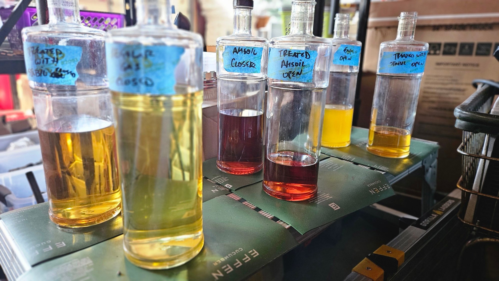

Untreated bottle of 20% gas 3rd row left.
The rest that have less gas are all treated but left open. (some gas evaporated)
The ones that are fuller were closed.
Front row right side is untreated but closed to atmosphere.

My conclusion:
TREATED ethanol gas is fine ....
Closed untreated ethanol Gas is also fine.
Closed gas tank and check valve vent should keep untreated 25% ethanol gas fine for a while.
Fuel stabilizers work.
I cannot see the dreaded "phase seperation" in the untreated gas. I would have thought it would be floating on top or bottom like oil and water ...
10% ethanol would fair even better untreated.
Wish I could test the octane.
Next test is how long will it take for the untreated gas to turn cloudy and/or show seperation.
