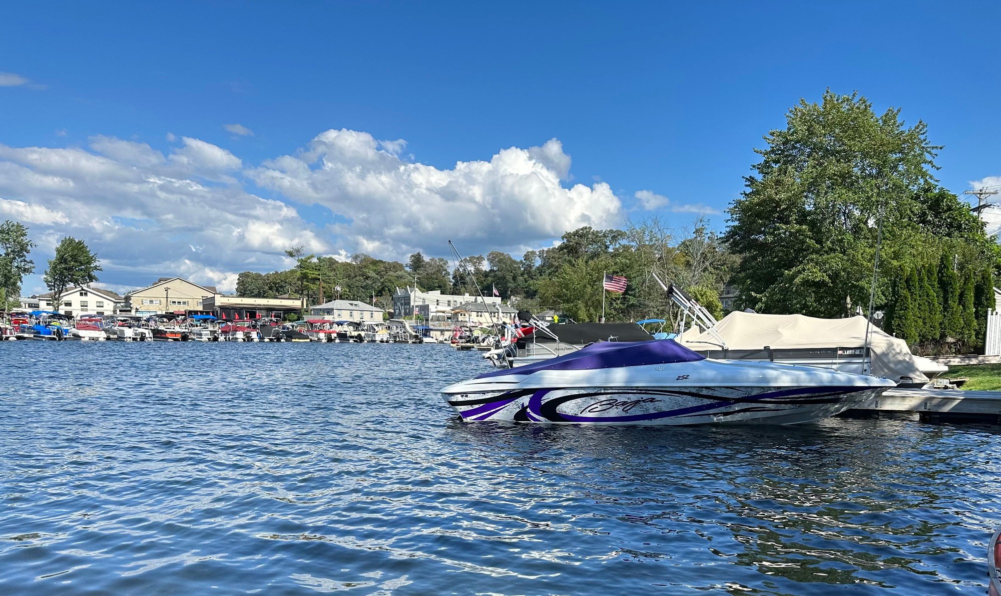

https://cimg0.ibsrv.net/gimg/www.off...ef876fd728.jpg
https://cimg1.ibsrv.net/gimg/www.off...cad4f44c4.jpeg
https://cimg2.ibsrv.net/gimg/www.off...6861ef50ca.jpg
I am a first time Baja owner and I do love the boat but I have to say the construction of it kinda sucks!! Engine on my 96 252 took a dump and when I pulled it the port stringer was MUSH, I dug it all out with a flatblade. The engine mount is simply lagged into the stringer, the fuel cooler was dripping and got around the lag wiping out the stringer. I replaced the stringer and made motor plates so this cant happen again! Baja motto, its got rot and it is doesnt yet it will!!!!!! I don't think there is a dry one out there!
