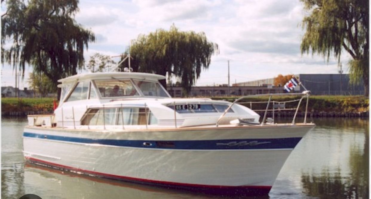

I’ve always been a fan of old Chris crafts after helping out when I was a kid rebuilding them with some old retired factories workers.
A few years back I did some repairs on a really clean 1963 37 foot Chris Craft cruiser and it really woke me up to what a lot of work you can run into deep down identifying a small surface problem.
This boat being a freshwater boat all its life and one owner was clean but it was rotting from the top down. Rain water penetrated the cabin top and leaked down the side of the frames and rotted areas of them.
A small runabout would be far less work than a cruiser but if it was sitting out in the weather rain water is a rotting killer.
If you have a heated shop and need a winter project for the next 5 years and are prepared to use the original boat as just a pattern Go for it.
This is a Crazy project here.
