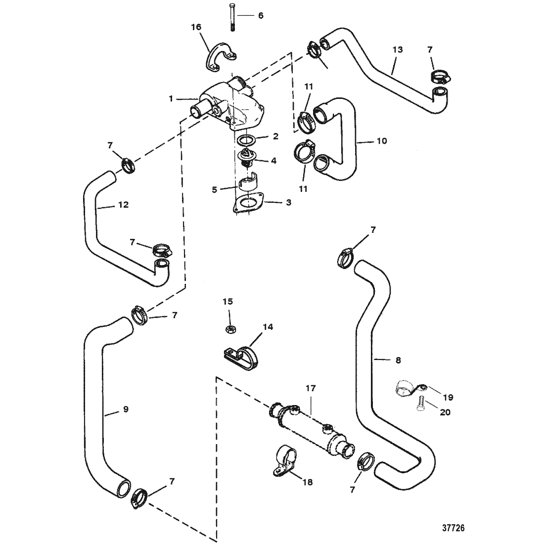

Alpha system:
Outdrive pump, to transom thru small diameter (5/8” ?) hose. Inside boat, top of transom plate, there is a nipple fitting bolted to top. Hose connects to this, routes under motor on passenger side , just after motor mount it will go to power steering cooler. Hose goes from this up front if motor to the thermostat housing. Housing will prioritize water going to engine (recirculating pump) and the remainder to the exhaust. When engine thermostat opens, that water will also get routed to the exhaust. Since tstat prioritizes engine, more water will thereflow flow to engine with tstat open.

Found a water flow chart that shows what I explained: (most older engines don’t have a fuel cooler, but have ps cooler where fuel cooler is in the chart)
this information is perfect. It gives me something to focus on and track down. Before this I was at a loss. Thank you so much
