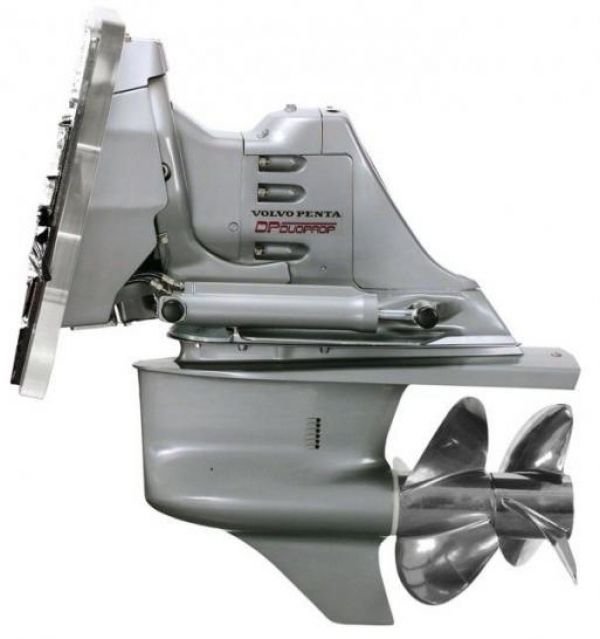

I was under the impression the dual prop was quicker? so i could convert this to a bravo if it breaks and parts are hard to find? looks like they make adaptor plates to do this. I will spend money on this boat because it's what i always wanted and its in great shape.

I think its a DPS? there is no numbers on it. it has a c7 prop set up but it needs more prop
this is a DPA
This is a DPA, this would be in the same era as the year of the boat
This is a DPS, it has the same transom cut out as a merc, has a faster lower and props

I found out there is not many prop options for this drive. It has c7 props now and that is the highest pitch available and i am running to much rpm already.
Can i change the entire drive to a bravo? who would i go through to the parts to swap?
