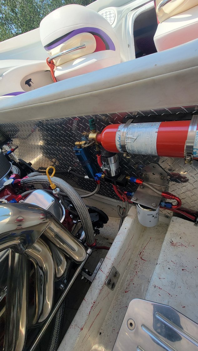

Trying to figure out who makes these headers so I can call them and ask where to install my wideband. They look like 2 inch cmi but I can't find any part numbers that make sense.

They look more like Stelling headers to me. Brand really does not really matter. I'd have a bunge welded in this area
How to install oxygen sensor bungs. - Offshoreonly.com

My CMI's have 8 digit serial numbers stamped on the flanges that look just like that. I have been able to call them and give them the number and they can look them up.

Thanks guys. The wideband thread was excellent, that is what I needed to see
