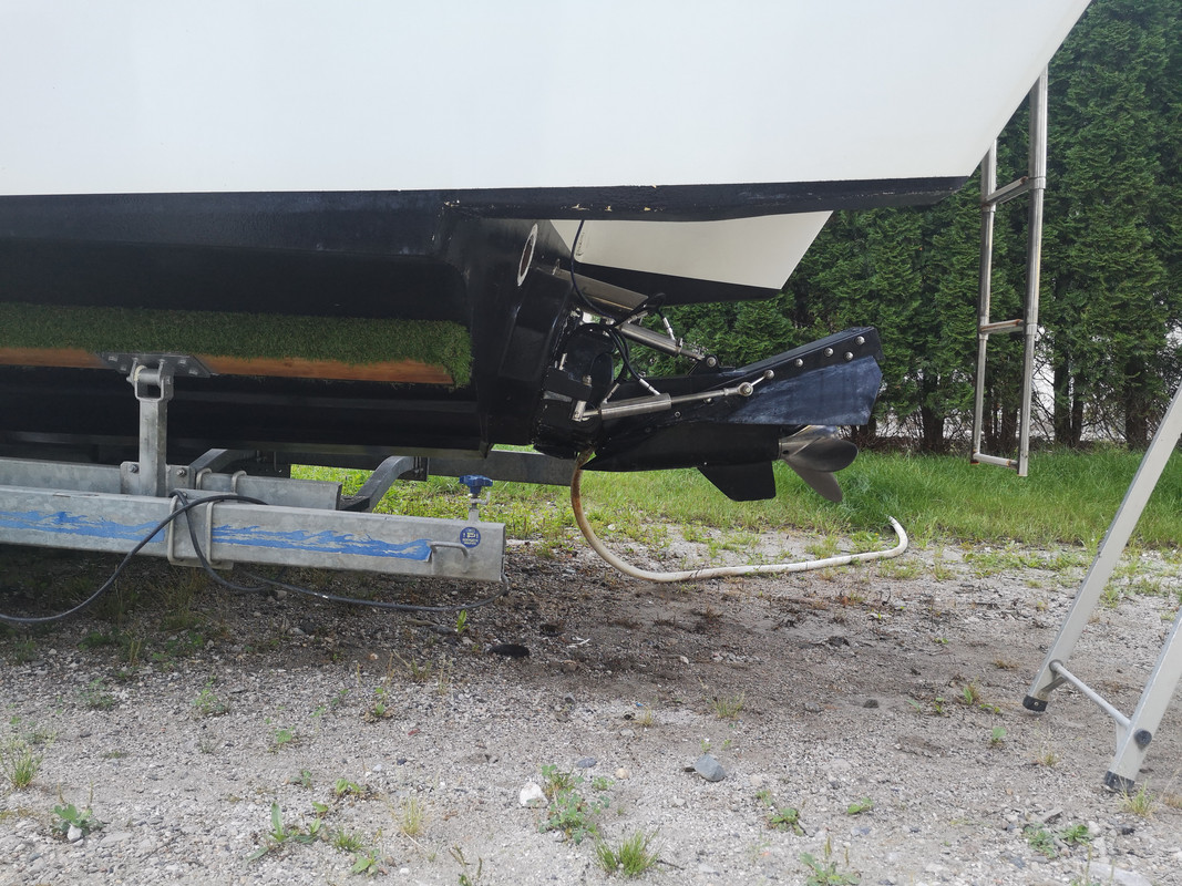

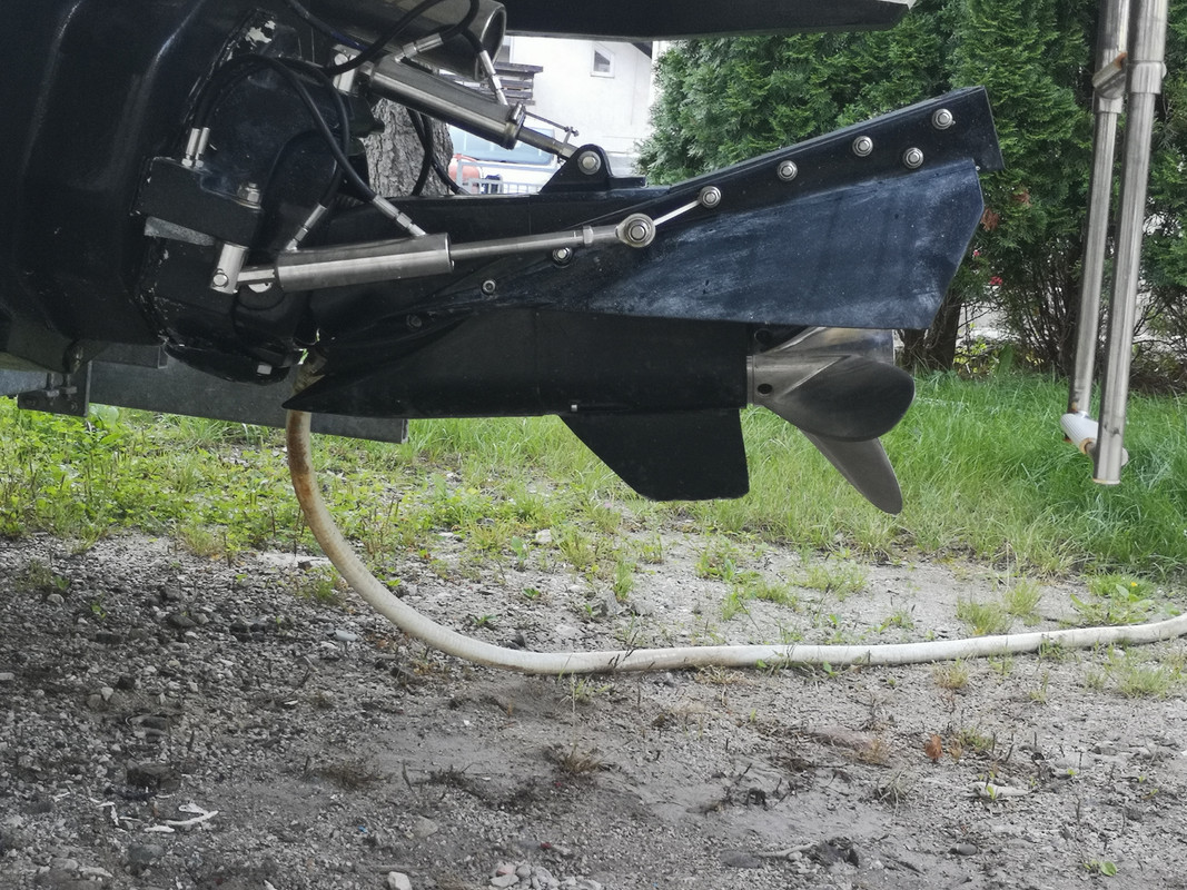

But I still don't understand something:
I have over 20 years experience with a faster small 14ft speedboat. I am trim up until the speed increased. When it stopped with acceleration I put the trim back a little and it went over the chine walk without any problems. I never had such isues.
I tried the same thing in this case. Even with this high trim, the speed was still slowly increasing, but I had a strange feeling and didn't go any higher. It feels like the skeg is gave way much faster than the propeller. Is it possible that the skeg is too small? There are two fotos with problematic trim angle.
In the future, I will definitely use smaller trim angle, but it would still be good to know this round skeg, and if it is to small, I have no problem lengthening it. A boat uses almost the same amount of fuel liter/mile from 35 to 50 mph, and these are almost the the speed limits for future. It is intended for longer routes and not for quick jumps around the bay. Anyway, I'm asking for an opinion about skeg.
https://i.postimg.cc/hGvr9Wd0/IMG-20240815-082236.jpg
https://i.postimg.cc/zG07bXVB/IMG-20240815-082247.jpg
