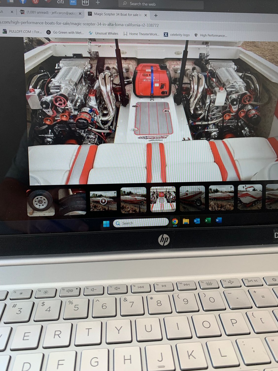

offshorexcursion 11-30-2024 12:41 PM
Really like our Predator 3500 instead if using the loud Onan onboard our Motorhome. The MC Metal works extended run fuel tank makes it's even better! I've used the Hondas in the past and they are great but just can't justify the cost, you can buy multiple predators for the money.
Just not sure how you will safely store and use a portable on your boat? There's a few cruisers in our area that use portable but they are all ghetto trash lol. The onboard generator on our cruiser is amazing, quiet and efficient. Why not install one permanently?

LakeBoat4 12-01-2024 02:33 PM
I have a Honda 2000 in my Cat that is mounted/places between the engines. Using a ratchet tie down strap for quick takeouts. Using the through hull stainless tubing exhaust with a 12-14" tall loop to prevent any reversion with a stainless tubing connector if I want to take it to the beach or dock. EZ to start and silent when the engine hatch cover is closed. I don't have A/C but but it runs everything else with reserve. If 2000 watts is not enough There is the Companion 2000 unit to add for higher demand. It is a simple few wire hookup. Never had to use it though, got it on the other boat for the battery charger, it can work independently.
Got the Predator 4500 for the house backup and one for the race trailer. Was $750 each when purchased last year. Works great for the race trailer that has A/C it is louder than the Honda but not by much. It has electric remote start so would not even have to open the boat engine hatch. It is like 4 times the size of the 2000 Honda and weights 110# compared to 45# each for the Hondas.
My choice for the boat is the Honda. For everything else is the Predator. Honda $1000 each, Can get the Predator with the 25% coupon for $750.
ICDEDPPL 12-01-2024 04:29 PM
zz28zz, thanx for that info.. I`m in hvac so I got all that power/ hard start covered .
LakeBoat4.
Pretty much what I wanna do.. where did you put the exhaust relative to the water line ?
Any vibrations that you can feel while it`s running .
I have tons of space in this cat, lots of room in front of the engines too . Finding a spot shouldn`t be a problem.
LakeBoat4 12-01-2024 06:41 PM
The exhaust outlet is on the transom about 6-8 inches below the waterline. No real noise except for the bubbling sound. The stainless loop goes up about a foot over the exhaust outlet on the generator.then down to the transom fitting below the waterline this keeps it cool as well. The generator is mounted on a fiberglass cover that is over the batteries and pumps which absorbs any vibration that the rubber feet on the honda doesn't.It all works Great. You do need to chock the Honda to get it to start on the first pull.the carb is not electronic.

Met a guy w a 29 Outlaw several yrs ago from Tx that mounted a small Honda in the bilge of his boat. Plumbed out the side. Very quiet. And Nice an Cool in cabin.
I was impressed.
He`s probably not alive anymore. RIP :angry-smiley-038:

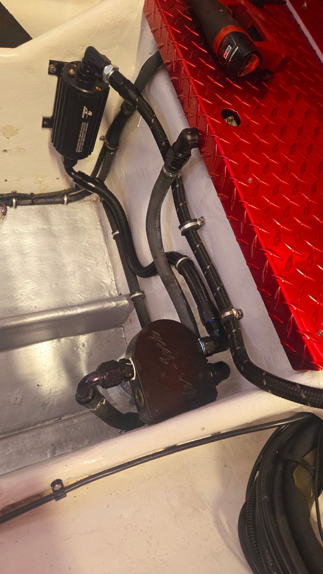

I bet that bilge was tight ... I have room for hours, in front of engines there`s a nice spot .
Not sure how I survived installing that secondary fuel pump , I spilled a lot of gas in the bilge ..
https://cimg3.ibsrv.net/gimg/www.off...979e7f1c25.jpg

I don't recall if it was in a 36 or 40 etc. but I've seen a small portable Honda mounted in the back on one side in the area where the bilge blowers and p/s junction lines etc. all are.
