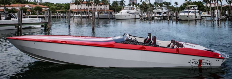

When I was scouring the interwebs everyday for a 39TG, this was for sale.
It was a FLA boat, painted white, and had the thru hulls coming out under water. Terrible lol.
This was back in 2018
