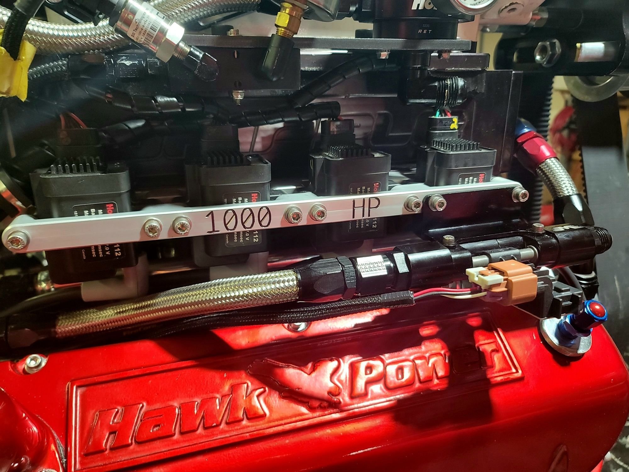

I ran a GM Flex Fuel sensor and Holley tune.
Like a car I could mix any percentage or regular fuel amd E85 and it would compensate. I found anything over 30% E85 was deminishing returns.
The IAT`s dropped significantly with E85.
It was a great set up.
