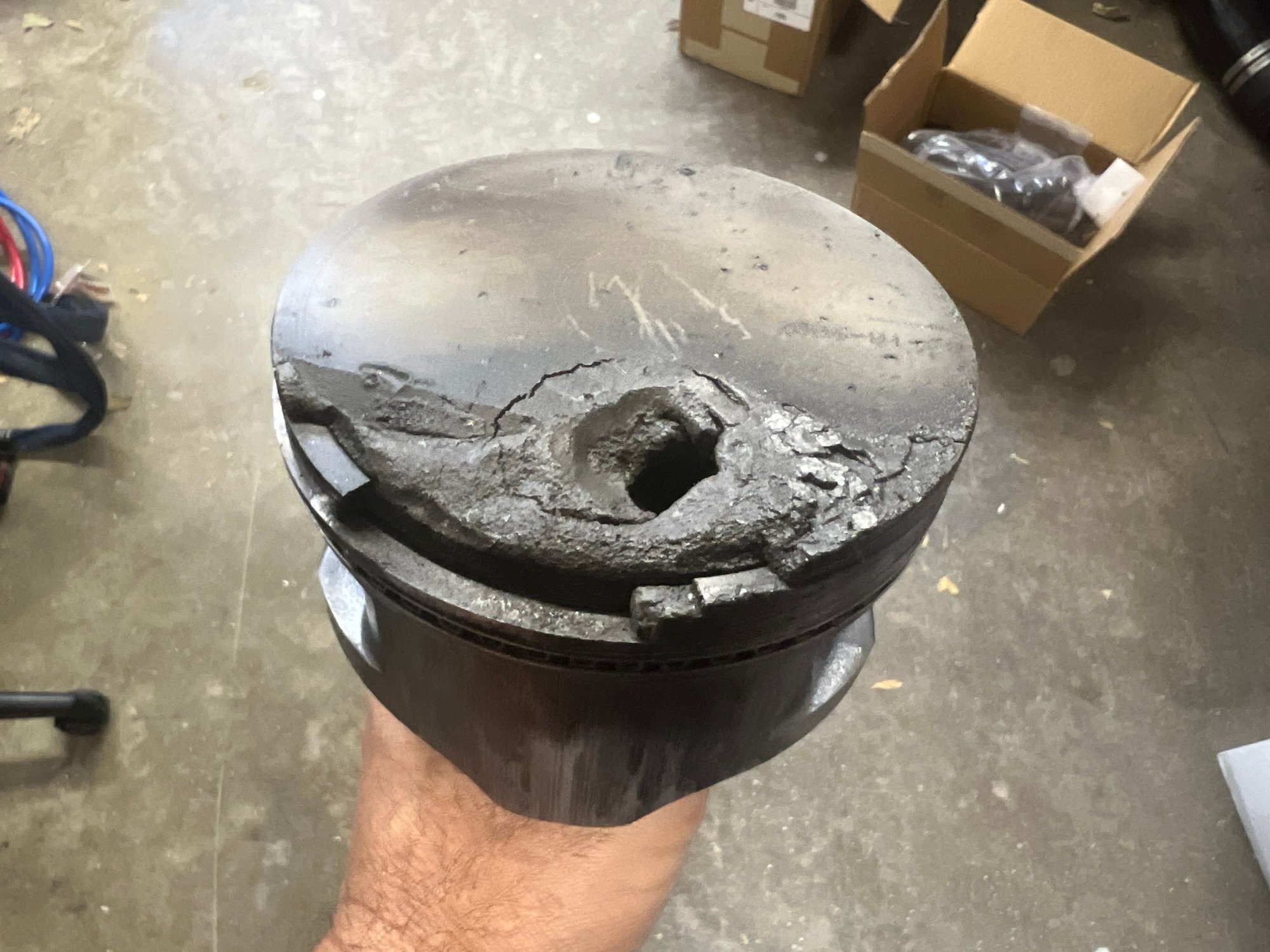

TexomaPowerboater,
A bad injector didn’t do this, but it’s definitely on the menu with one. Gonna wanna be sure they’re in good shape.
