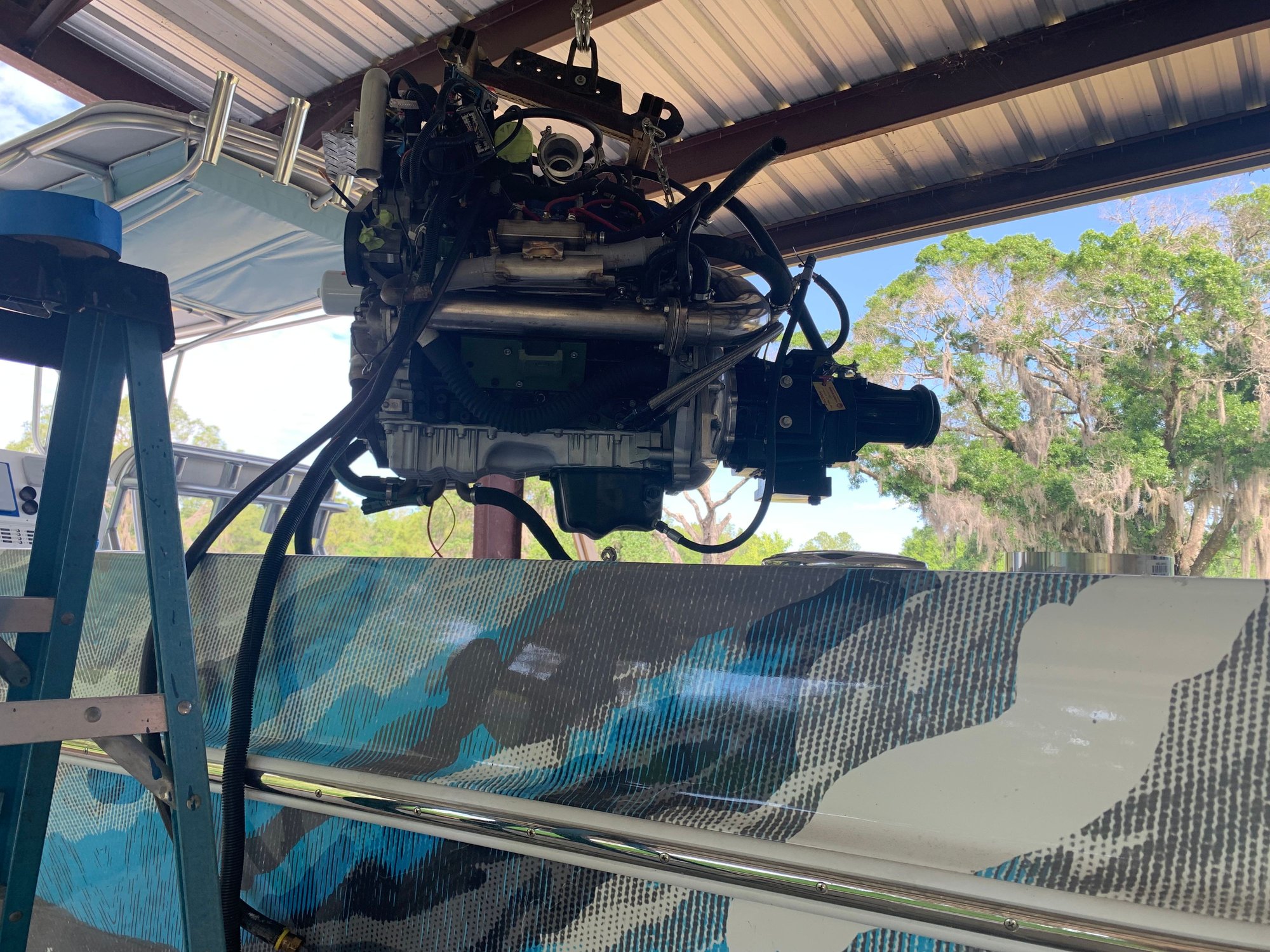

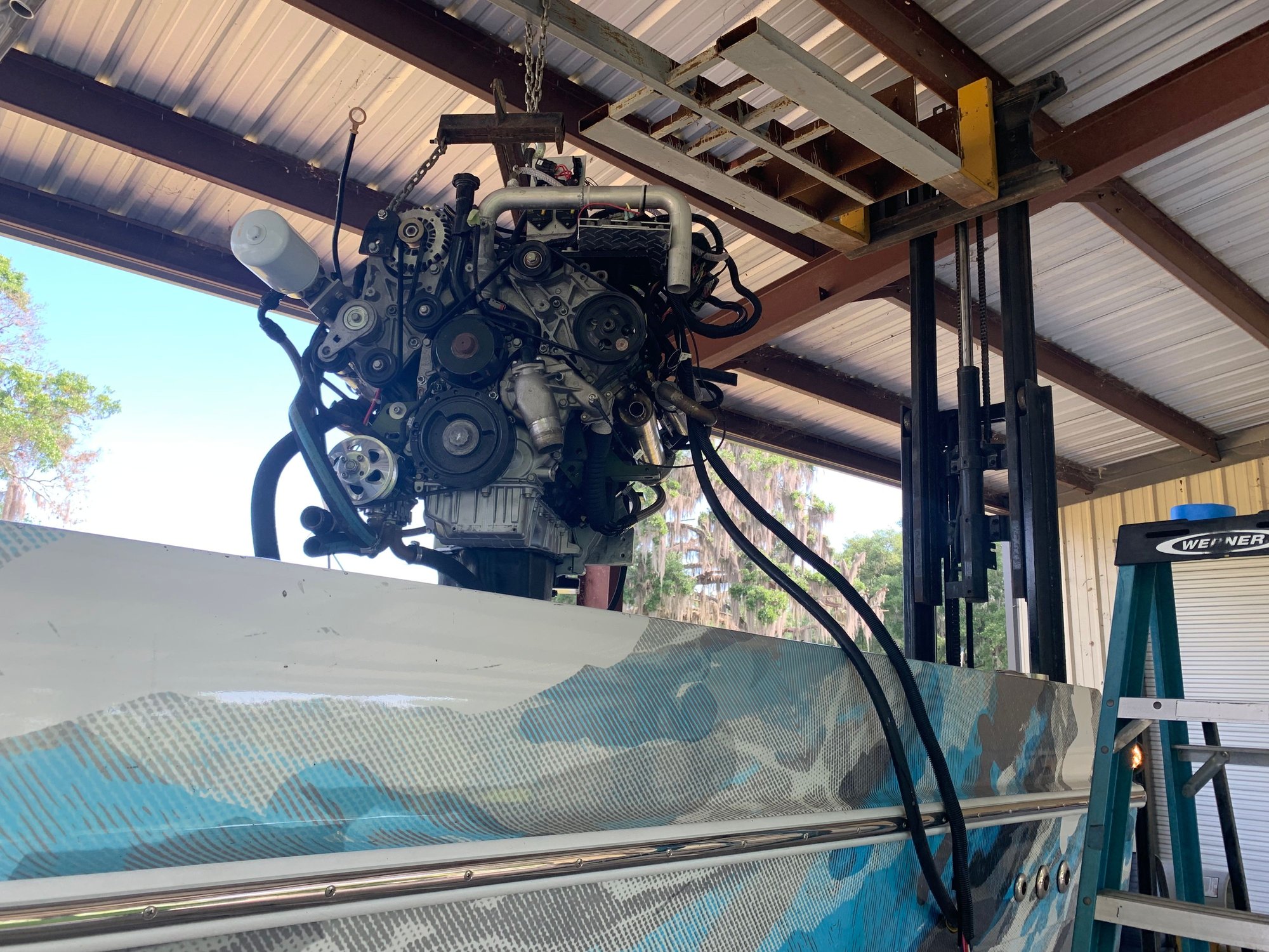

I have a pair of Duramax LML’s with only test hours if your interested.
They run great, but I repowered with new 370 yanmars. I don’t like the way I set up the intercoolers and heat exchangers remotely. Got them back on stands to try to integrate everything as one unit to simplify plumbing.
