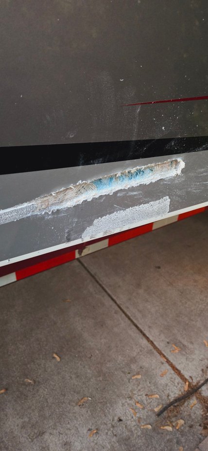

I found the hard way about the construction
That looks like at least 1/2" of solid glass with extra foam behind it for more strength. Nortech v bottoms are all solid glass and Kevlar mix. don't see why they would do it different in their cats.
The hull sides are foam cored.
