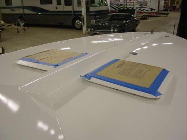

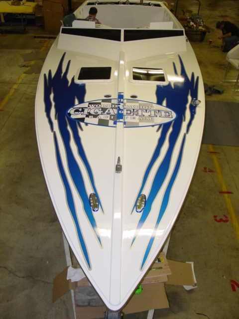

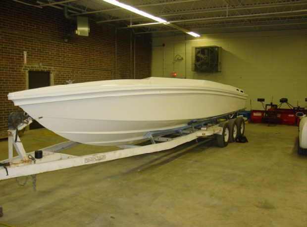

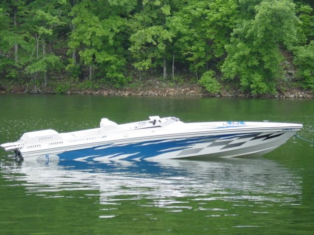

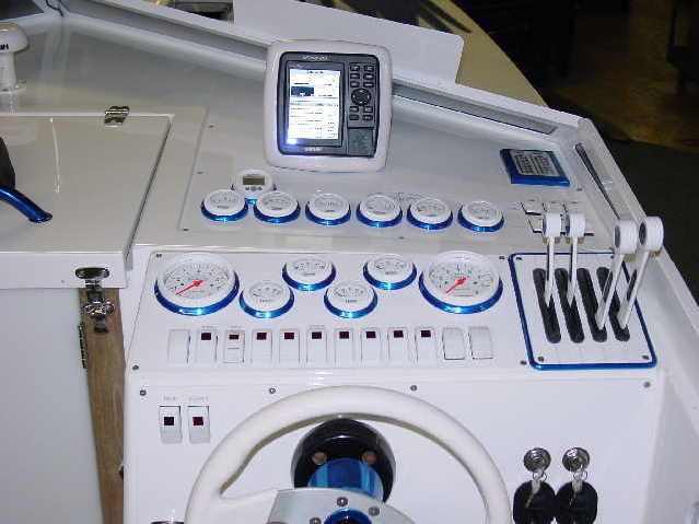

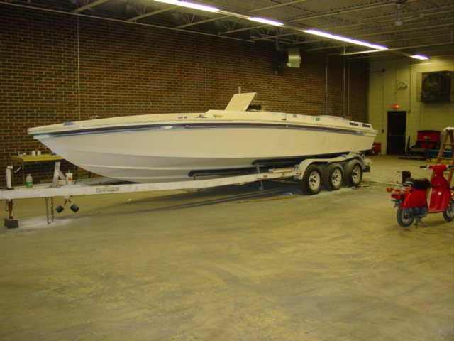

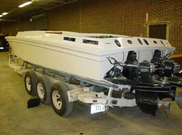

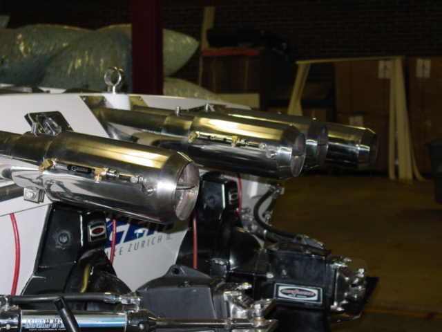

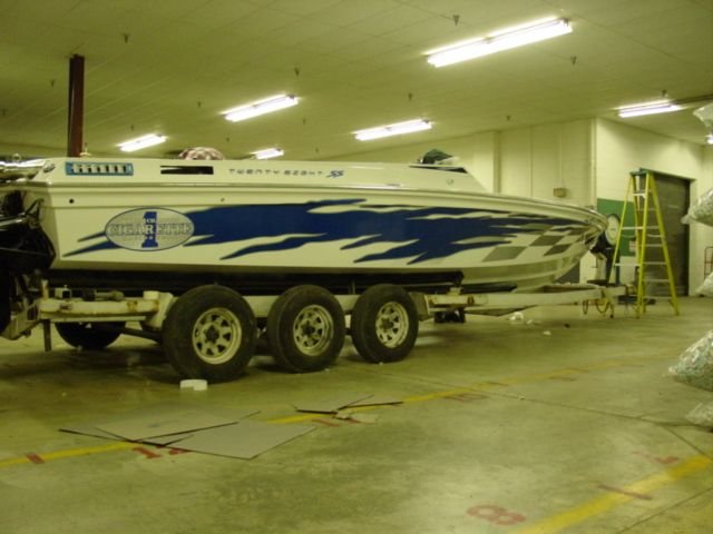

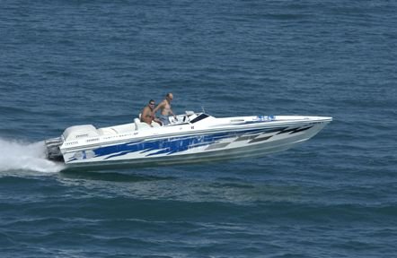

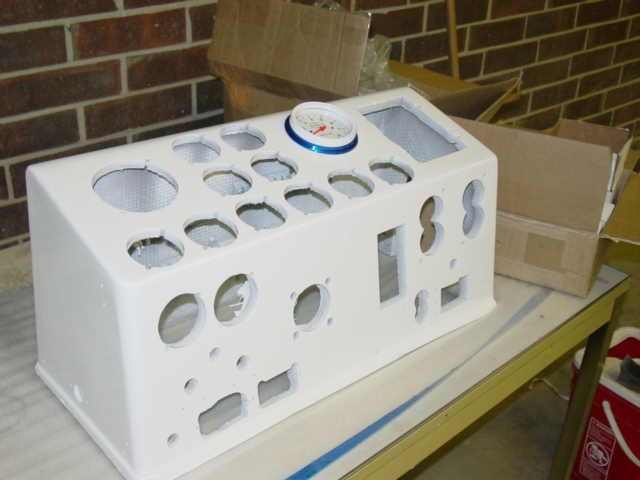

Heres some before/during/and after pics of her
that pic of it running was her last time out during a local run here in Chicago with the older brother running her
-Wally
-Wally
Its a 1976 bicentennial edition....it has a 3-man bolster in front right now. Thats how it came stock from the factory. In those pics she had two bolsters in front that were removed for another project and the 3-man was put back in...
