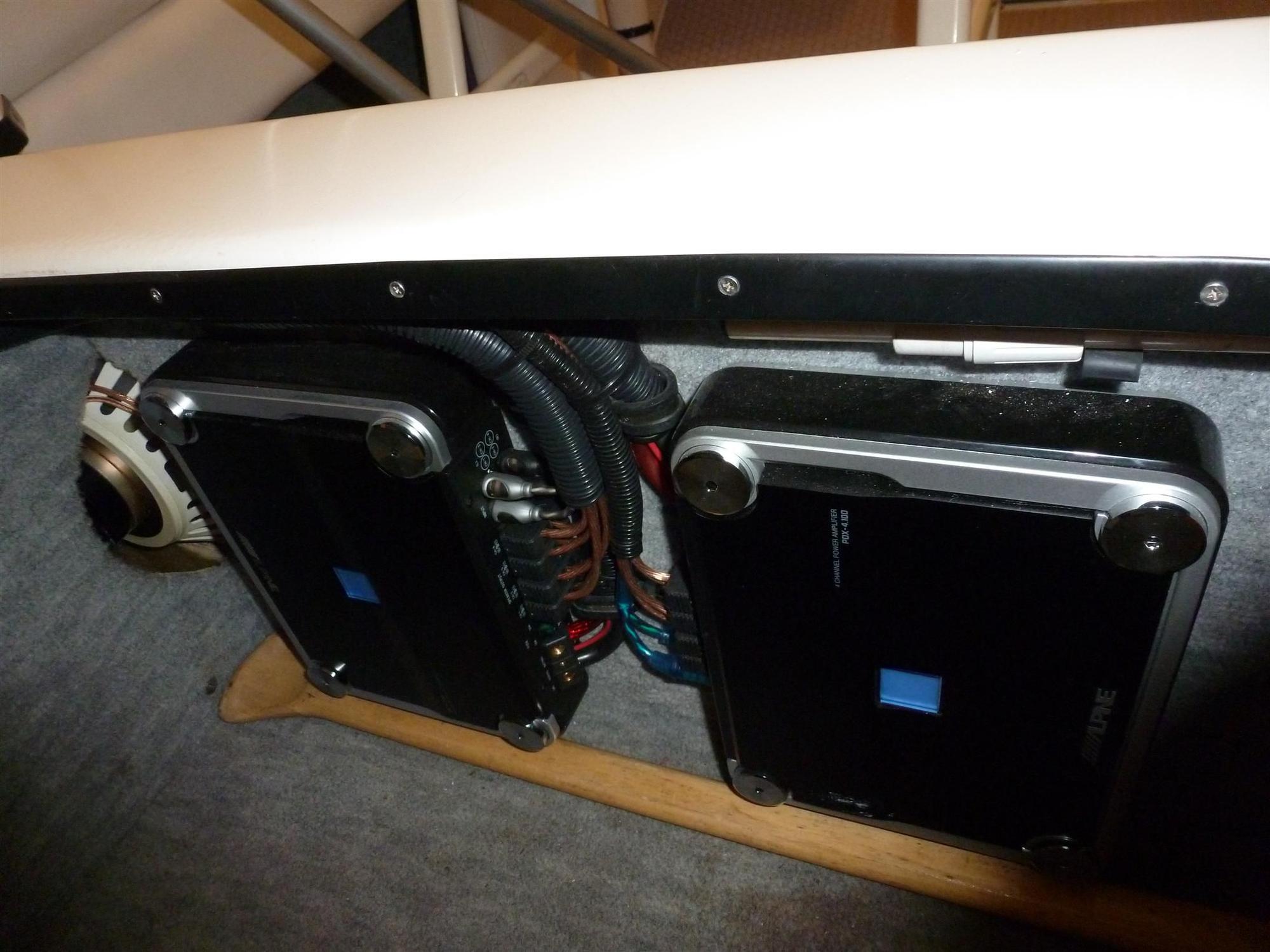

Mounted under backseat

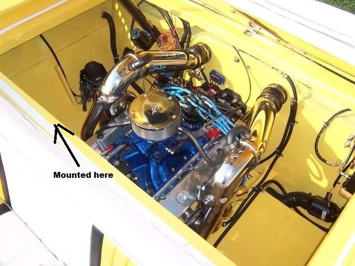

On my 251 Convicor I cut a piece of plywood, painted it with fiberglass resin, then wrapped it with white seat vinyl. I mounted it in the starboard side engine bay behind the seat back, but not screwed to the seat back itself. The top screws were in the cross beam that the engine hatch closes on, and the bottom was screwed the the bottom seat base structure. That way when I removed the seat back to work on the front of the motor, the plywood and amps stayed there. They are two Sony marine amps and still going 15 years later.

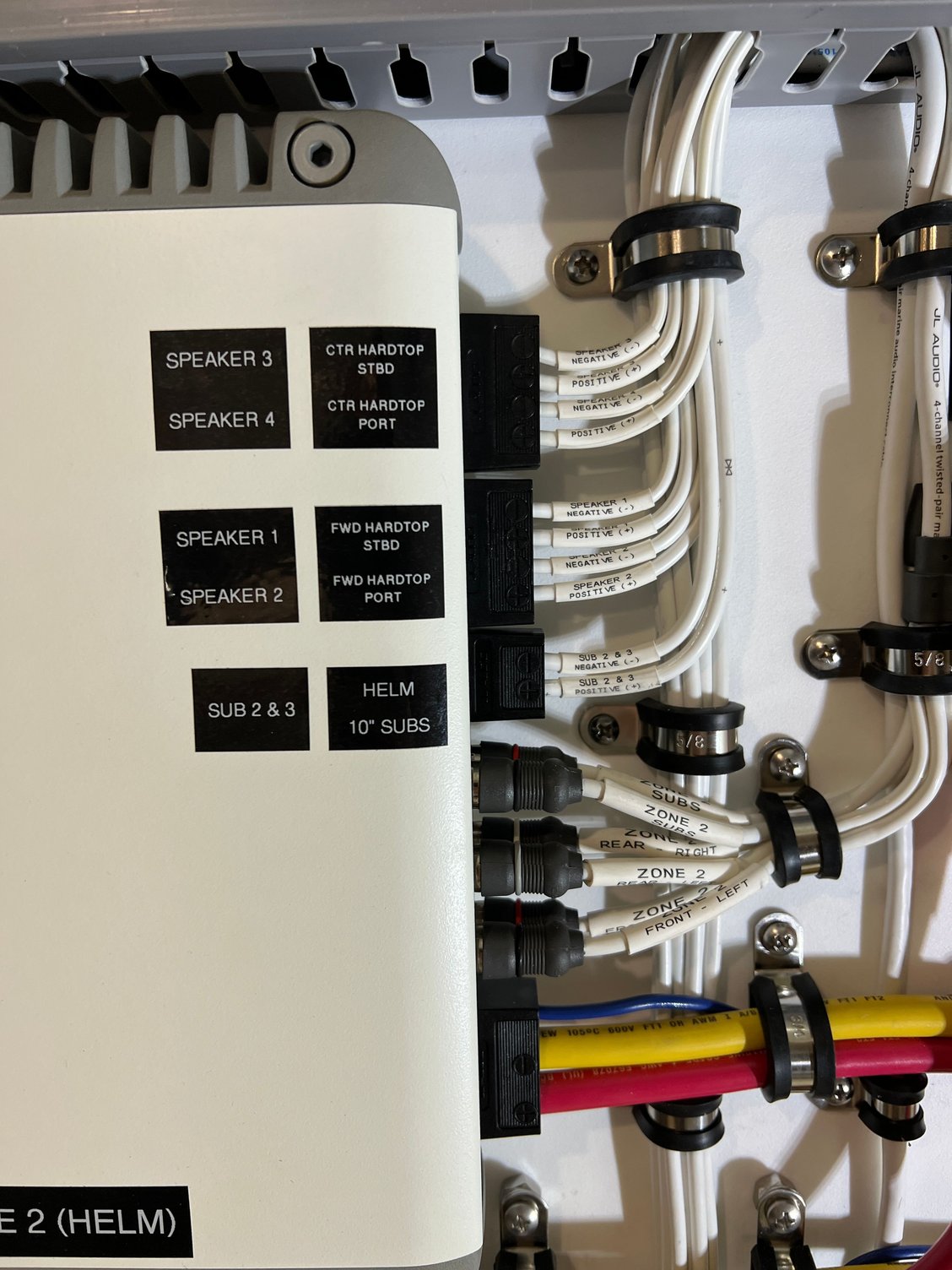

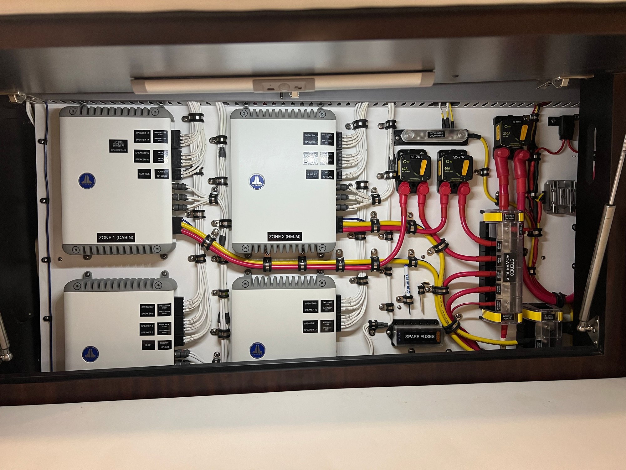

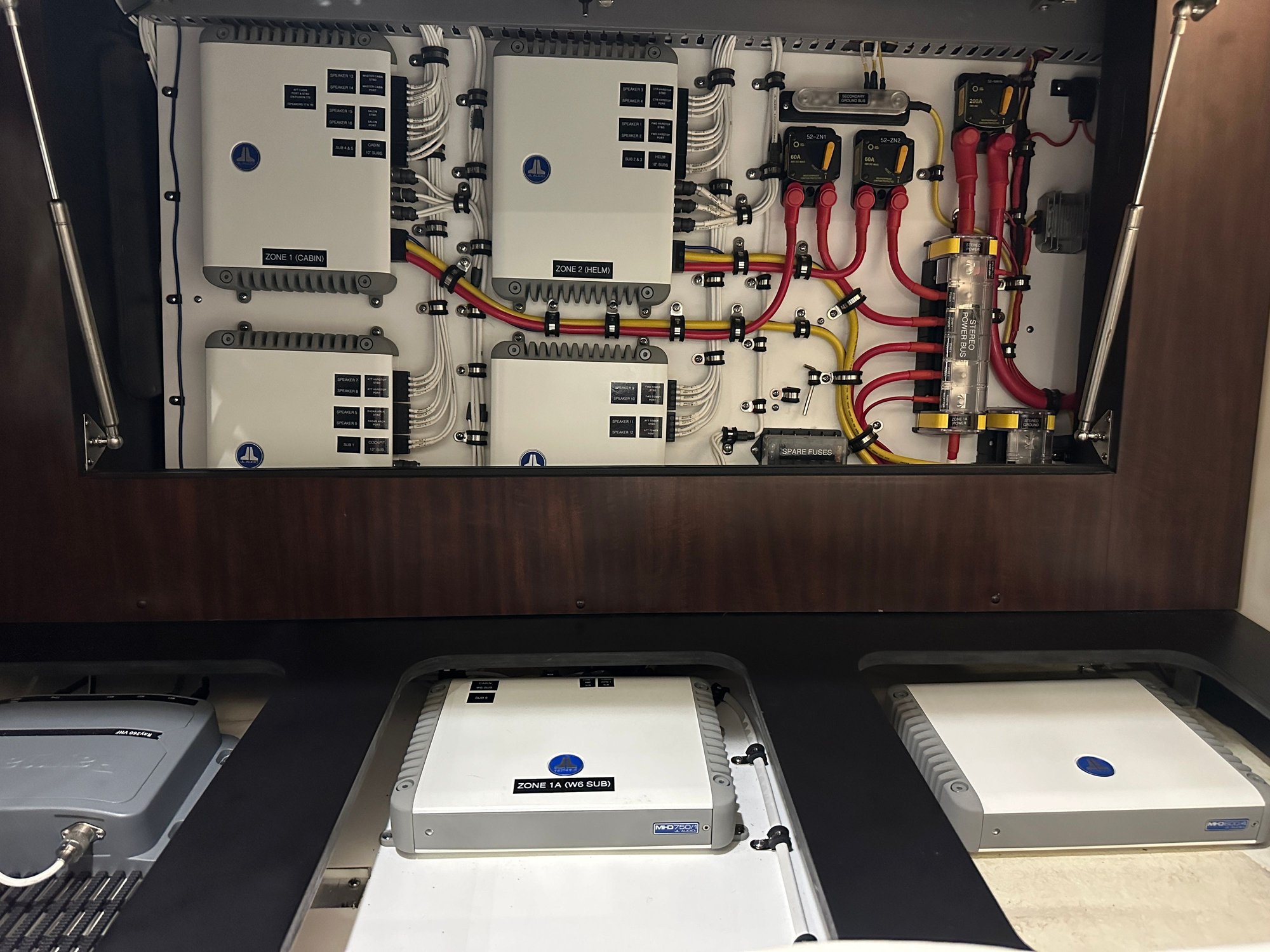

This is on my Monterey 335SY (cabin cruiser). 100% DIY
(4) JL Audio M6 8.8” Speakers
(8) JL Audio M6 7.7” Speakers
(6) JL Audio M6 6.5” Speakers
(2) JL Audio M7 12” Subwoofers
(1) JL Audio W6 10” Subwoofer
(4) JL Audio M6 10” Subwoofers
(3) JL Audio MHD 900/5 Amplifiers
(2) JL Audio MHD 600/4 Amplifiers
(1) JL Audio MHD 750/1 Amplifier

One of the cleanest installations I have seen, very well done!
