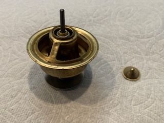

Last weekend my engine started overheating. Sea strainer is full of water and swirling. Exhaust temps are normal, verified on scanner. I found the cap came off the thermostat, so the pin was unable to open the thermostat. Just replaced with a new one. Same problem, slowly overheats. It took a good 15 minutes and it started hitting 180 degrees (normal is always 150). No water in oil. No bubbles or pressure in coolant tank. Circulating pump is not dripping. Is it possible for the circulating pump impeller to fail? Or??

what temp is the stat and where did it come from?

Thanks guys! Well, brand new replacement thermostat and the top piece came off the first time out! Thanks Hardin Marine!

china junk
