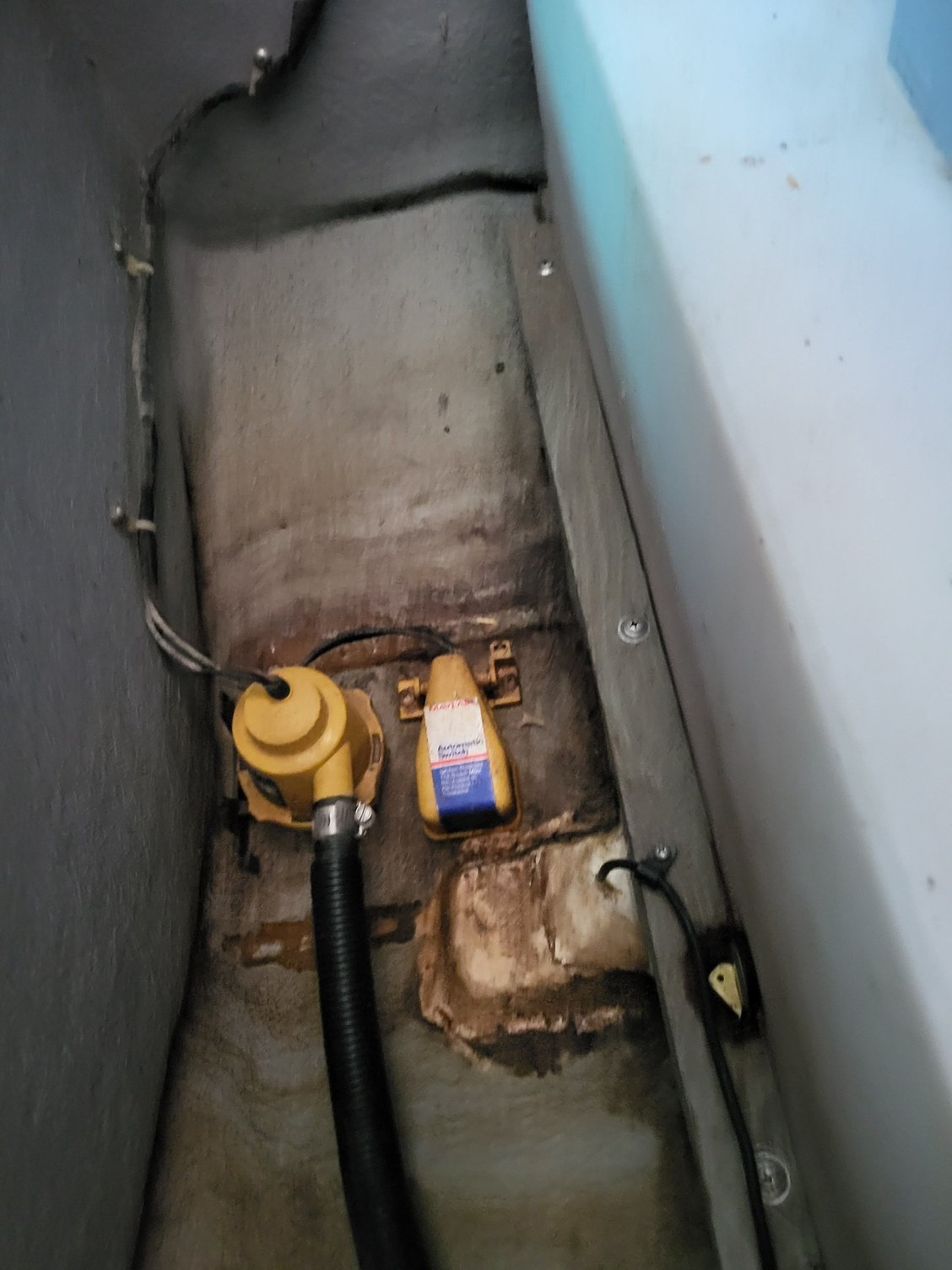

On my new to me 1988 261 liberator the dash dept gauge is not working, it does get pwr and the screen night lights work
the person before put in a older garmin and it has a transducer which i think i found glassed or epoxied in near the fwd bilge
see photo, its the yellow hump thing
the factory one is still wired and in the hull aft
how do i test it? was thinking use it to see if the garmin works using it, but its a 1988 and the garmin is a 08 vintage
any ideas?

The "yellow hump thing" is bilge pump and float switch
Liberator,
I think he's referring this yellow hump thing.
Thanks. Brad.

Liberator,
Thanks. Brad.
yes my fault
The yellowish hump next to bilge pump forward.
this fwd pump and float works
but the yellowish hump appears to be not native to the build.
second part .. if I buy a new Garmin.. Will the transducer work, or will I have to mount it on transom, its about the size of a ballpark hot dog, minus the oinions

My bad. It didn't look yellow on my screen.
