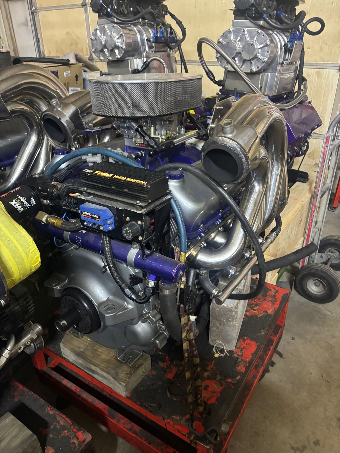

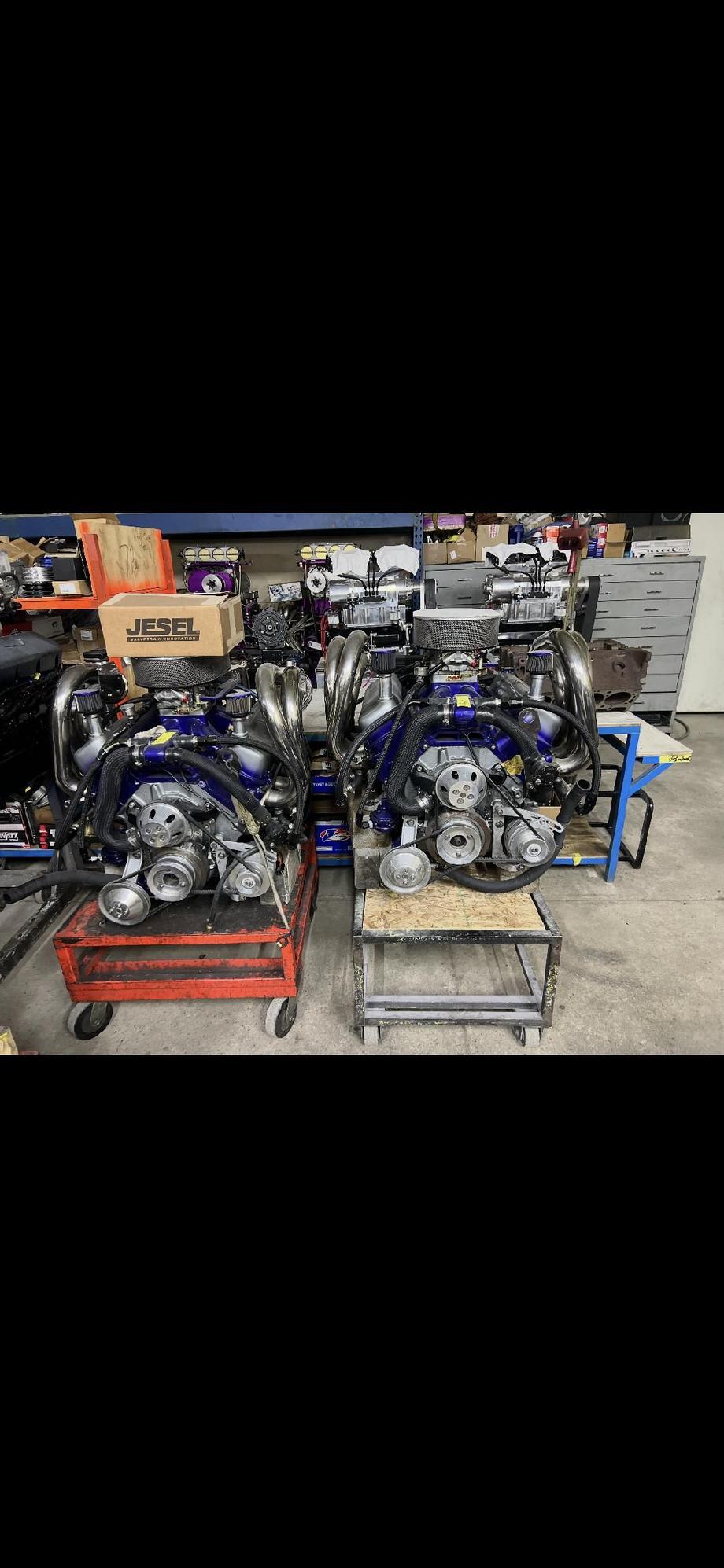

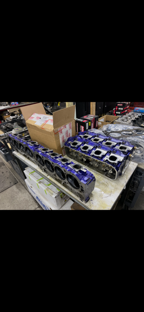

Engines are out for refresh, paint and dyno pulls. Go Wesco Racing!

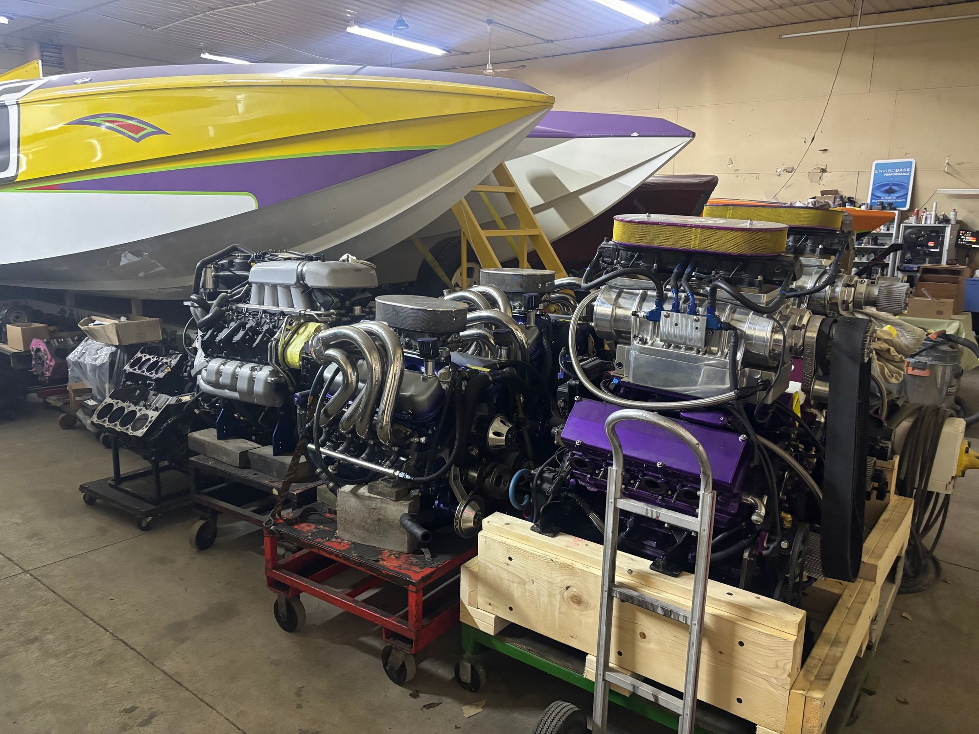

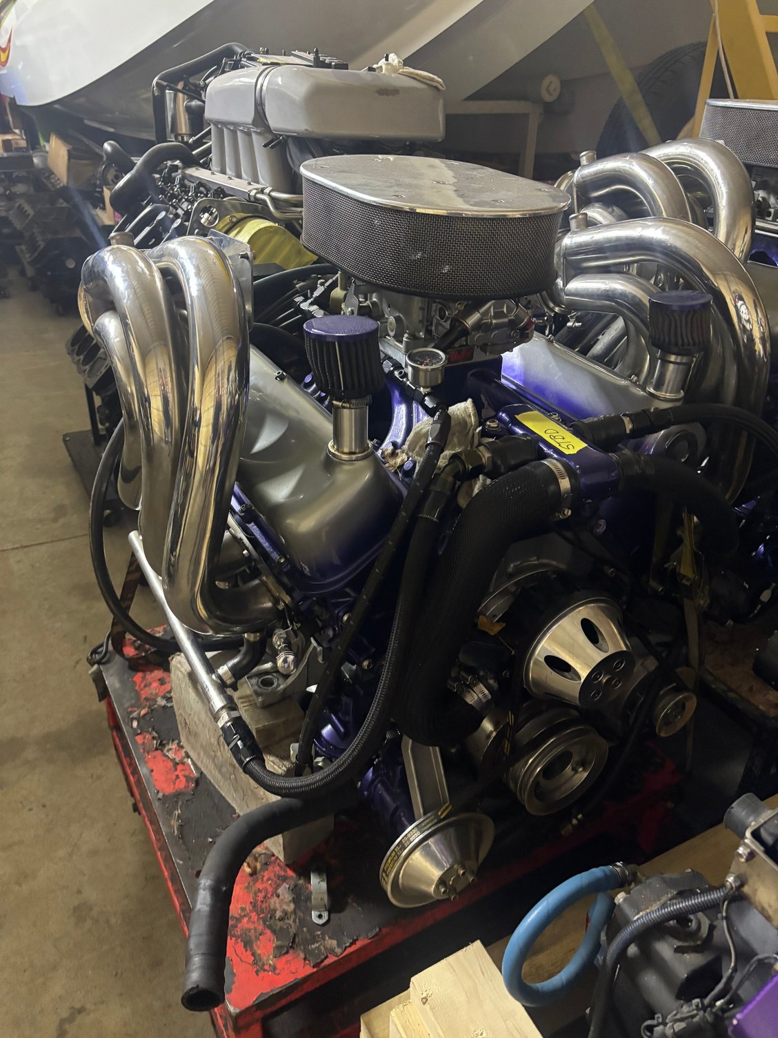

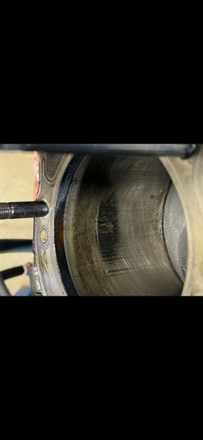

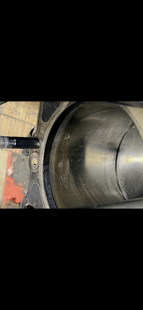

Motors being taken apart. Looks like water damage found from reversion. Is it the cam, the exhaust, mufflers???

The engines looked good before being opened up!

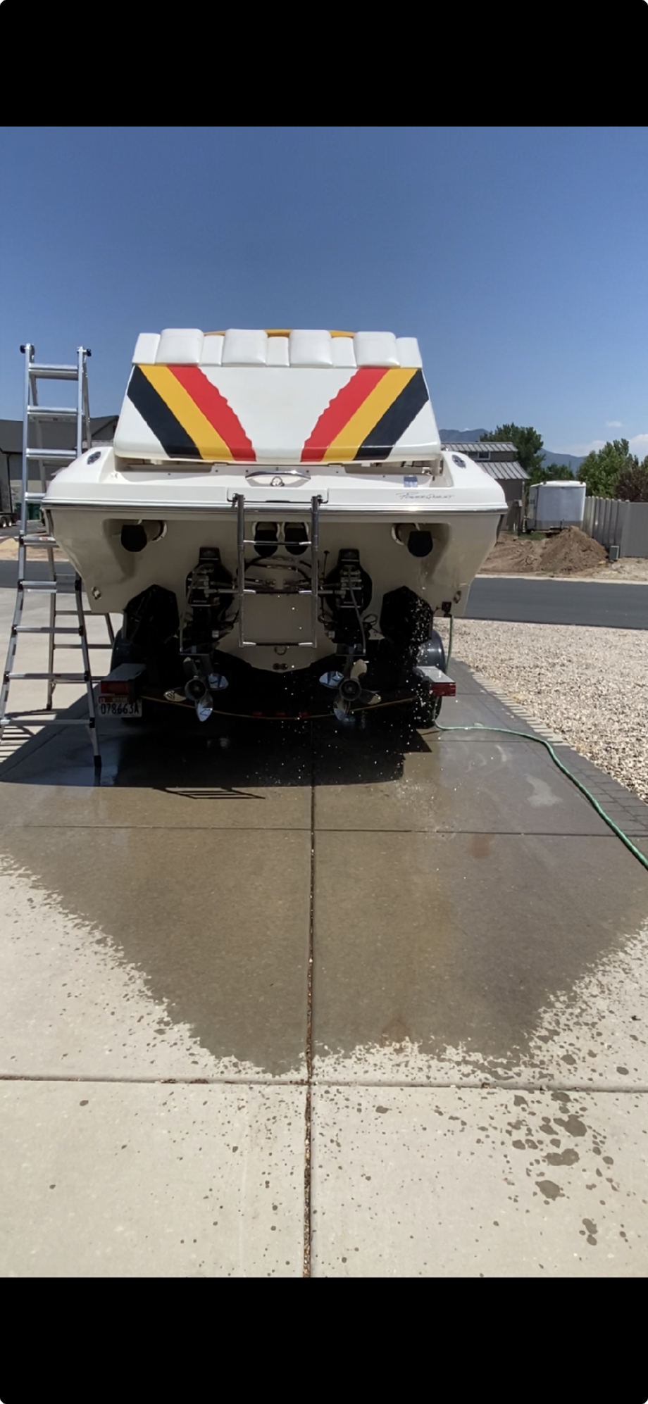

When I purchased the boat it came with large muffler exhaust tip extensions. I took them off immediately but I'm wondering if they contributed to water reversion at some point.

Dry Exhaust would solve the problem

How difficult is it to convert to dry exhaust?

New pipes, new tails and a hole in the transom!! (Ear plugs optional)
honestly, pretty expensive given the cost of CMI Headers!!

Why new headers? He could just do tails.
