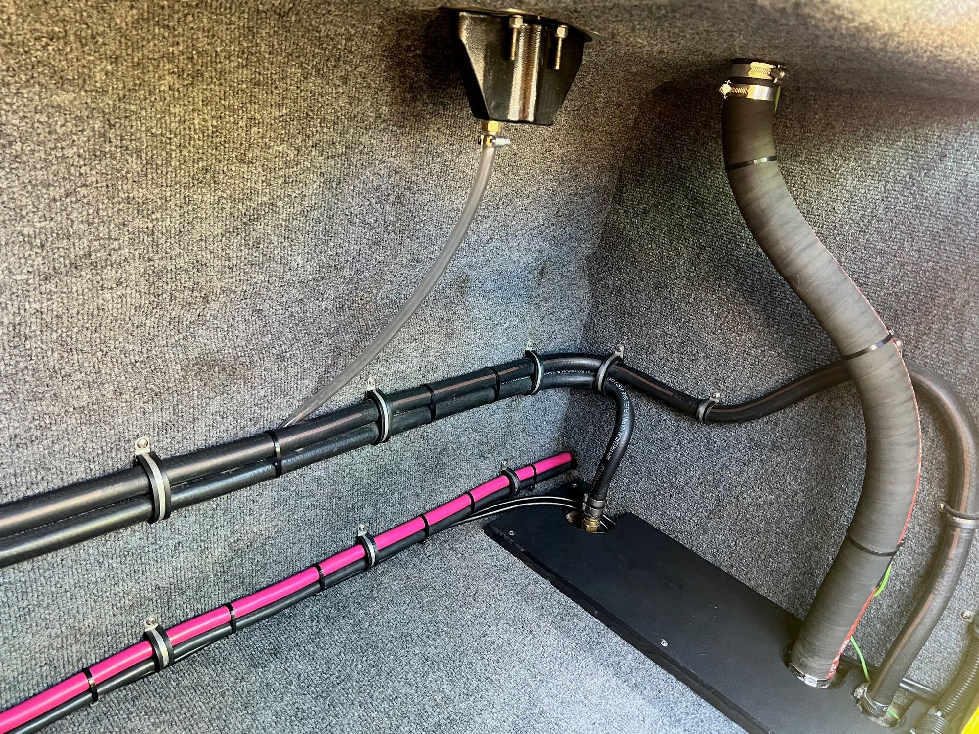

Originally Posted by Milam11
Diamond Dave yes sir I think I got it from the guy right after him there in Havasu. He said the motors had been gone through and refreshed but no paperwork. I still rolled the dice. It’s funny you mention the windshields, I thought they were actual glass so I had a guy come out to tint them just to find out they weren’t lol they look damn good though!
so if you look at the fuel setup in the picture, being there’s not a return back to the tank, for the bigger gets filter to be getting water in it straight form the tanks it would have to be coming from there. I think my next step will be adding a loop in the vent hose, and then draining a couple time like you said. Even thought about adding another filter in line to help clean it out faster and give me some more run time If that makes sense? If I was just getting it in the secondary filter after the cooler I’d think more about that being the issue.
When I had everything drained and gone through in August, one of the things we did do was injectors thankfully.
In your picture the "top" hose is going to your fresh water flush valves correct? Weird there is no return to the tanks (I'm no 700sci expert someone else can answer that lol) unless it is ran up next to the stringers that are more towards the center of the boat then over to the tanks? My return is not on the tank you can see/ access from the bilge, but up in the gunnel area on the front of the tank. You can see my vent, return and the fill in the picture.

Joined: May 2023
Posts: 22
Diamond Dave correct, top hose is going to the fresh water flush valve. I will have to check and see if mine is up that way. I do believe we are on the right track though.
