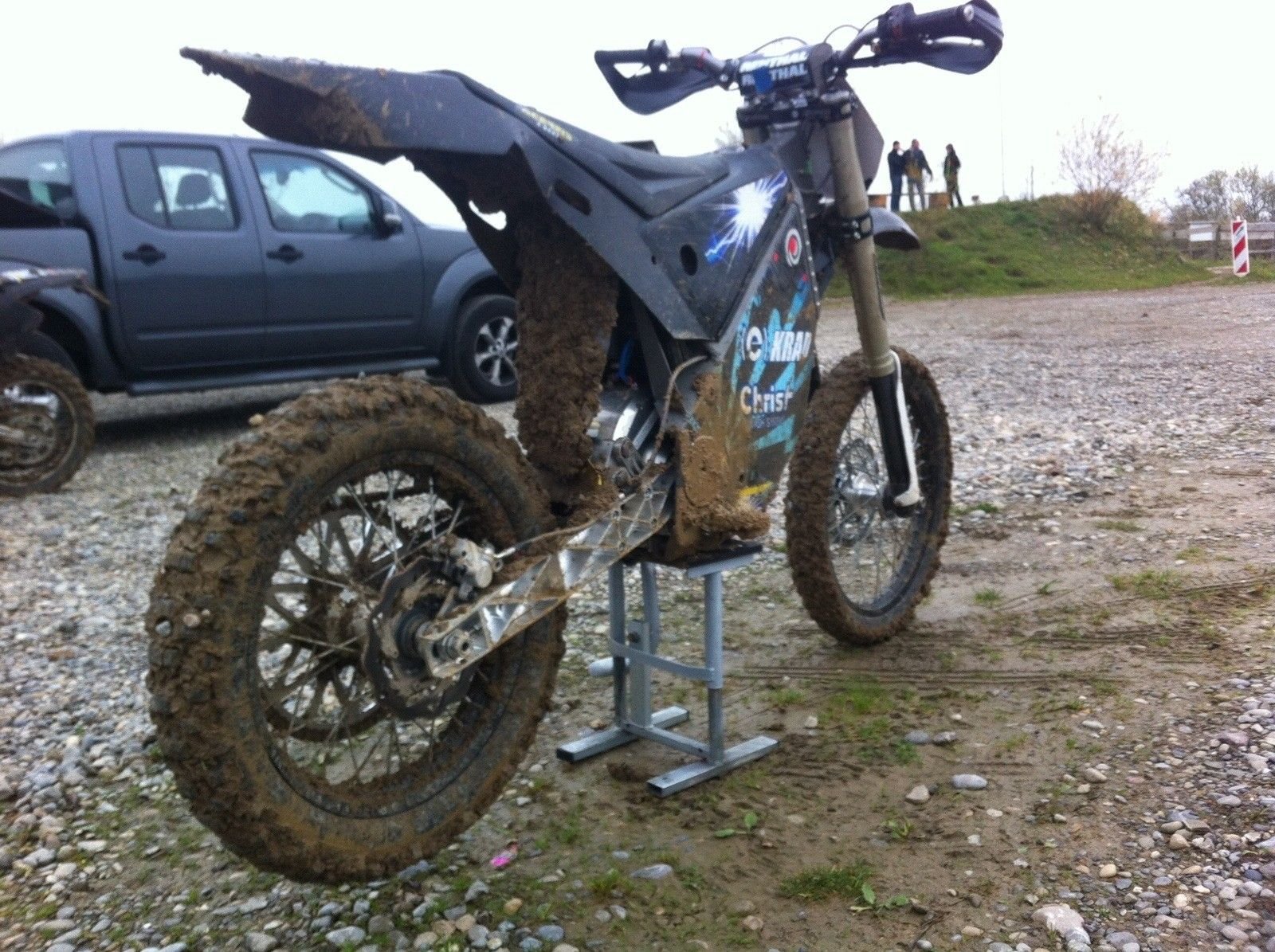

The battery will be made by myself I guess, maybe 27200 Sony US VTC 6 cells, as I have written before I have made some electric motor bikes. One motorbike battery had 600 cells inside and had a capacity of 6.5 kWh and a weight of 32 kg so around 44 of these packs should fit in the boat. This bike was able to produce 50 horsepower and you could go at least 1 hour on the track. Bye the way this picture was made 2015 long time before Stark Vark.
