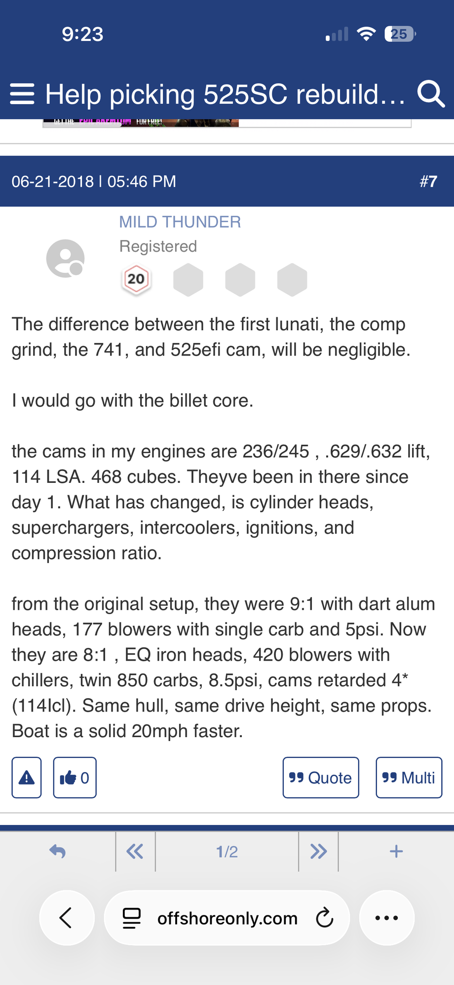

whipple 2.3 side mounts by Smitty in frankenmuth mi
700-800hp
454 build and dyno test
525SCs modded
Another dyno session, 454 w bm 420 megablower
Mild thunders 468s, went 96mph in a straight bottom 38 fountain.
700-800hp
525SCs modded
