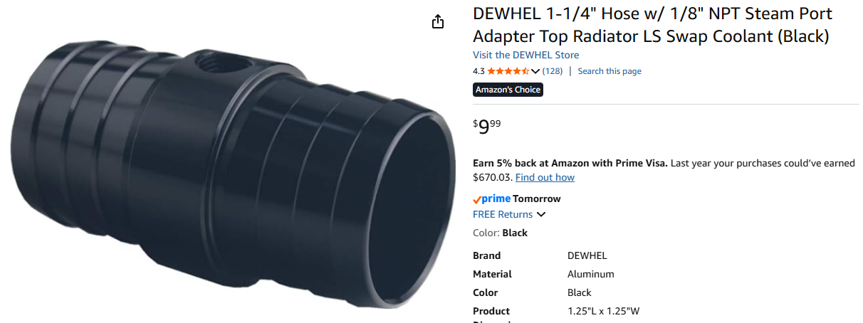

Thats what I was looking for yesterday! Got a link of that fitting? Thx!

Mine is closed cooling FYI. I run a 13 plate box oil cooler and I see 185 degrees at cruise.
This is what I used to T the autometer gauge in just past the seawater pump.
