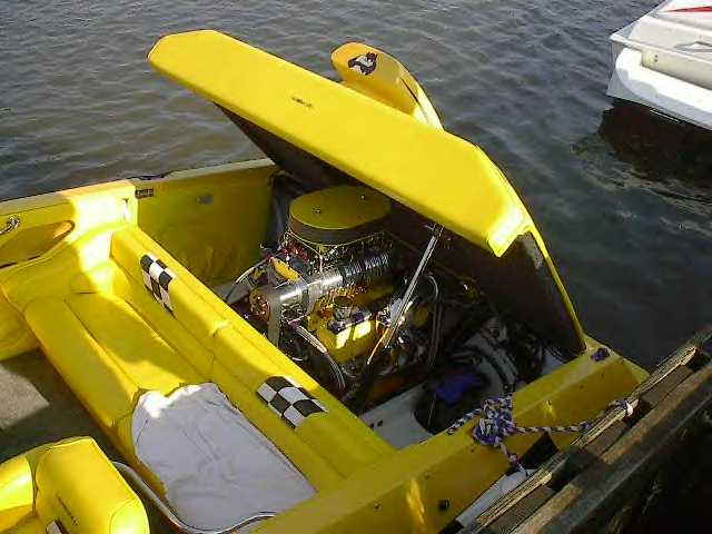

I've used a two part epoxy paint. Thin it down and brush it on. It will look like you sprayed it..

Barry - Did you sand first? Did you use a base coat/sealer?
