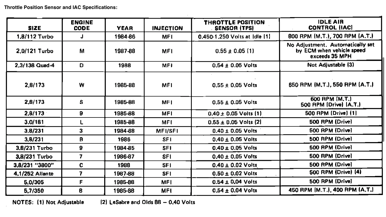

h
Here you go, in the flesh diagram. A 1988 and older 3.8l red dot V6 found in the 1988 Oldsmobile Cutlass Ciera Cruiser does have an adjustable TPS sensor. The goal is 0.40, volts plus or minus 0.05 volts.
THIS DOES NOT APPLY TO 1988 LN3 3800 motor. THOSE ARE DIFFERENT and do not look adjustable but I can’t confirm 100,000%
