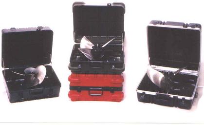

try shipping it in one of theese from mooring lines . com.
