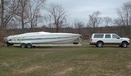

No Longevity here got mine 3 months ago pulling #10k Cig. Pulls great.
The babe (wife!) gets 13 MPG milling around town, we get 16 MPG on Highway and about 9 MPG pulling the rig. No issues whatsoever and stole the thing, bought it with 41k miles it's a 2002
