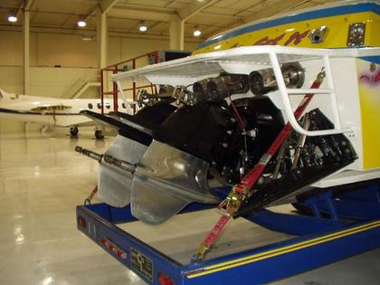

I found a pic in the OSO Classifieds of an Apache belonging to Peter Pavkovich.
In the pic you can see where the rear bunks contact on this hull. Only thing I can say is that the contact area must be where the greatest strength is in the hull. Possibly due to where the stringers and engine beds are? Same for the contact points further forward?

Directly above the chines are the stringers... stronger part of the hull... less chance of distorting the hull while it sits for a long time on the trailer.. That is why the bunks are put in those positions. I've seen boat trailers that didn't have good bunks.. and the hull sagged over the rollers along the bottom... ruined the hull... ( it was a junk hull anyway.)

So trailer mfg's don't put keel bunks at the transom to insure the outer bunks support the trailer at the stringers? That makes sense, but in the picture above Myco added a second bunk just inside of the outer bunk that lines up near the stringer, and the inner bunk would support the boat where there is no stringer or support at all. Whereas there is usually a stringer along the keel in the engine compartment, but not in front of the engine compartment due to the fuel tank. In addition, half the weight of the engines is supported by the keel stringer in the engine compartment, which is not supported by the trailer. I'm no naval architect, but this is not making sense to me.
