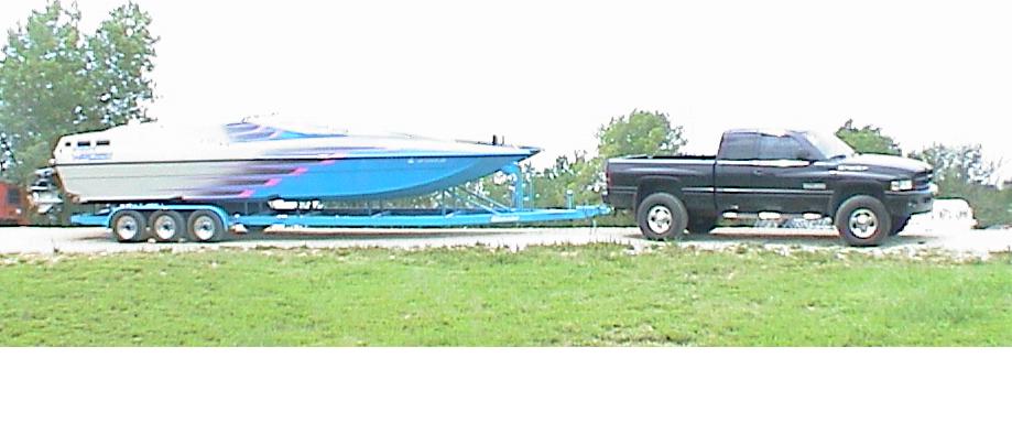

SubscribeI pull 7600lbs dry no trailer Warlock. Maybe 9500-10000 with trailer, fuel, etc. 2500 Cummins Dodge 4x4 pulls it pretty well. (Better than I thought it would!) Make sure you get a class 5 hitch (rated to 1200lbs tongue and 10000lbs total). They ususually sell most trucks with a class 3 (500lbs tongue and 5000lbs total) even with a tow package. Make sure and check this no matter what truck you get!
