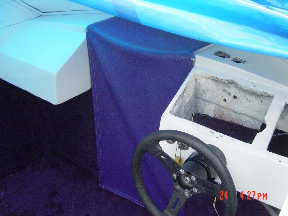

Well after two weekends I have removed the bolsters, controls, electronics\gauges, MM steering, K-Planes, Drive, Gimble Assy, and most all of the wiring and fluid lines. I am now were I can get a real good look at the condition of the transom, stringers, bulkheads, etc. So far it looks as though the previous owner was truthful about the transom being replaced a year or so ago. It is basically perfect. I am planning to replace the two fuel tanks and the surrounding bulkheads. It may turn into the two inner stringers as well, but have not gotton that far as yet. I have scheduled to have the transom and bottom awlgriped later on.
I took on taking off the transom\gimble assy today. Took me allmost two hours of removing the 3m 5200 that was used to seal the inner assy area. Glad it was there as it probably helped to preserve the transom, but man it was a royal pain to remove.
"Before" pics added below.

Here is a dash shot after I stripped it. Planning on doing a mod to the dash to set up for center steering.
