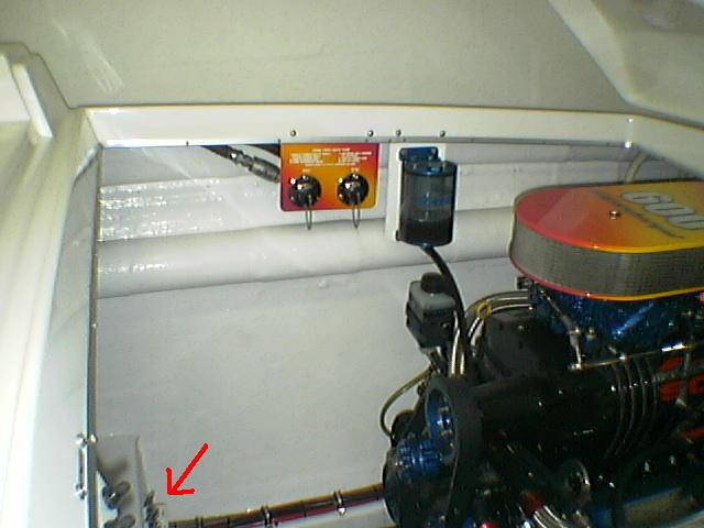

In our rig we have that to attach the hose and a pull lever shut-offs (look at bottom left of the picture) to shut the external water pick-ups to rinse your engines even when your staying in saltwater overnight. All boats from Lip-Ship come with that.

Sorry storm did not know it was going to come out that small.. It is a good size on my computer..
GLH -- That set up makes it nice. I may have to think abot that. SInce I usually have tendancies to leave the boat at the dock for the weekend. The town will not let us put a lift in. So Trailer it sits during the week.
