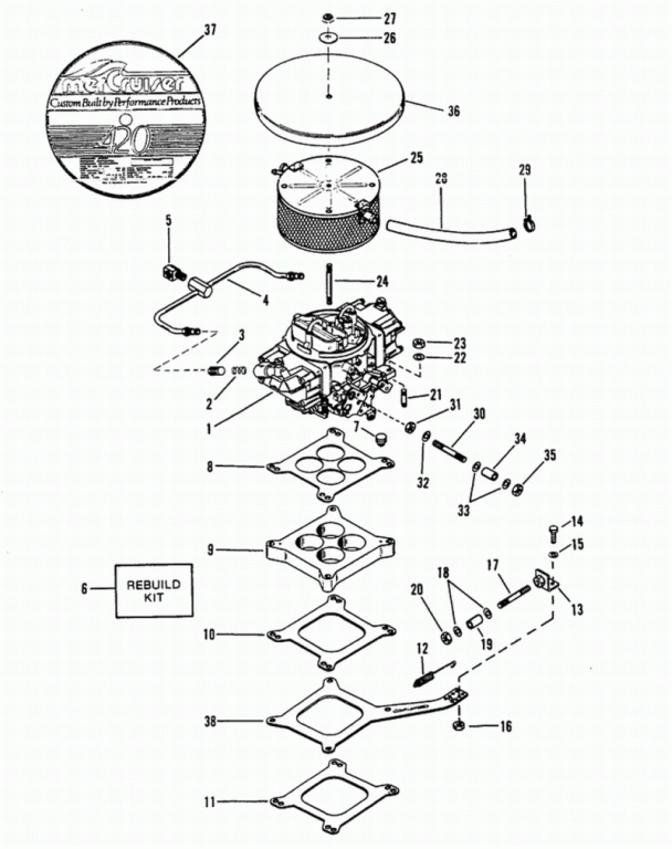

What does the light return spring look like and where should it go on my setup? There is a return spring in the diagram. Is that the light return spring you are talking about or is that the heavy one? The Heavy return listed in the diagram is not on my current setup. What would the light one look like and where should it go?

It's # 12 on that diagram. It goes between the ear on the plate that the cable housing ataches to, and the throttle arm on the carb that the cable end attaches to. Does that make any sense? What I meant by light reurn spring was similiar to the factory one, and not to use a stiffer one from an auto parts store to band aid the problem.

I don't think I understand,I'm probrobly a dumb***, but are you saying in the diagram one end attaches to one of the holes just above number 16 and the other end attaches next to the red plastic thing I was turning counter clockwise?

yes one end goes to one fo the wholes just above #16, the other end goes to the arm just above #7, that has the stud sticking out that the throttle cable end attaches to. there should be a whole or a hook for it to atach to.
