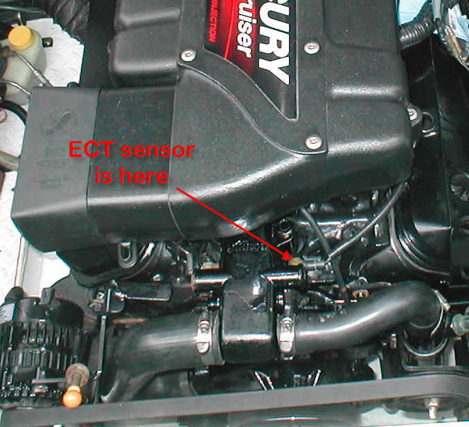

James,
Before you do anything else, at least check the connection at the ECT sensor.
Dave

where is this sensor? i just checked my fuel presssure(not running) and it looks like about 10-11 lbs. i'm going tofire it up tnd check the pressure then...james

Should look like this

thanks dave. it's plugged in. i changed the filter and pressure remained the same. no water in fuel. how can i test that sensor? thanks....james
