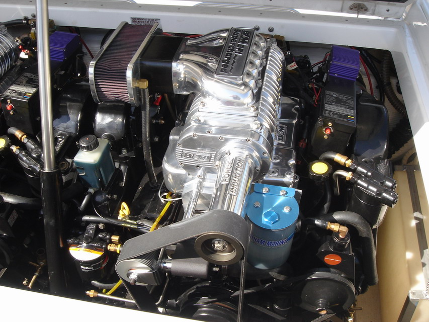

The B&M system uses the port injection from the 502 MPI. It has a B&M adjustable fuel regulator mounted in the manifold under the blower and purple B&M something or other that plugs into the wiring harness or maybe thats the ECU. It uses the stock fuel system.... Total timing is 30.
As this is my first fuel injected anything my knowledge would fit in a thimble but shouldn't the ECU adjust itself. For like temp, alt, air/fuel mix.... stuff like that.
Any help/advise would e greatly appreciated.
Jason
