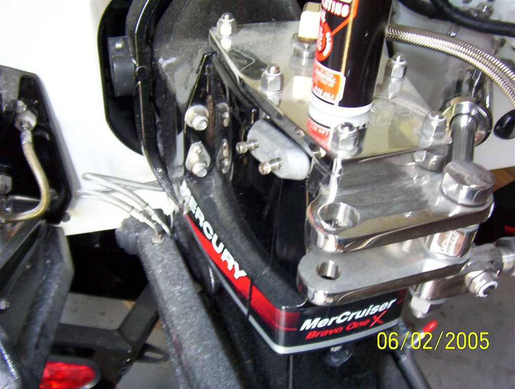

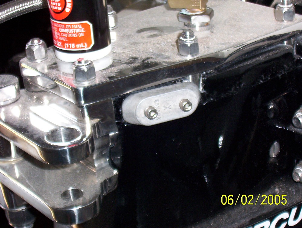

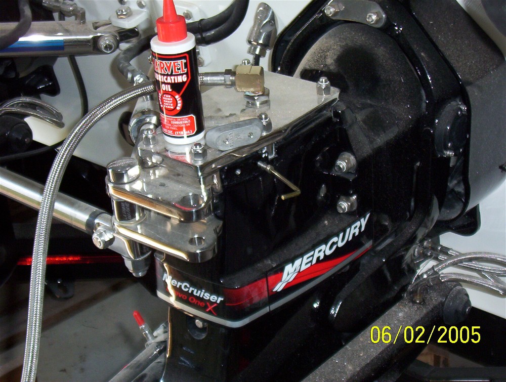

my boat is slipped 3-4 months a year in FW. With magnesium anodes, and properly functioning Mercathodes...I have all but eliminated corrosion.
One problem area remains. The top caps. With all that stainless high on the drive...the electrolitic effect is substantial, and the majority of sacraficial anode (magnesium in this case...FW) is at the cavitation plate level or below.
tired of this, I knew I needed anode to sacrafice up high in proximity to all that stainless steel bolted to the aluminum case...
after alot of thought and looking at available magnesium anode shapes and sizes...
and a good look at a Bravo top cap...
I found this mag anode for OMC/Johnson/Evinrude
Canada Metal #CM123009M
West Marine #1258623
comes with 2 threaded holes. Drilled them out, put a little chamfer...drilled and tapped 10-32 holes into the "void" area at the back of the Bravo top cap. Used allen head s/s cap screws and s/s lock washers. put a little pipe dope on the threads for the hell of it.
both sides of both caps...now there's something up there to sacrafice to electrolosis other than the caps themselves.
check it out. Everything is a mess from the Corsa muffler install ect. forgive me...
