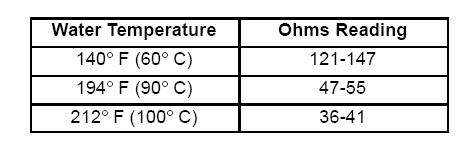

This is what the Mercruiser service manual says the sending unit resistance should be. Maybe the proper gaskets (with rivets) were not used on the thermostat housing?
Dave

Thanks for the input, guys. I put a 140 degree thermostat in this am. Now the temp reads and seems to hold at 179 ... much better. I think temp senders may not be the right resistance for the Gaffrig gauges, so the gauges read high. I'm going to test it with an infared on Monday just to be sure. Thanks, Dave.
