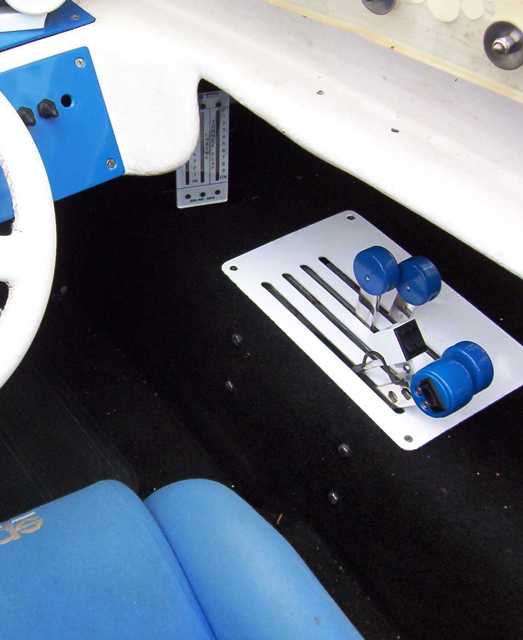

I have a gaffrig clamp on for my drives and I made a knob for my tunnel tab. They are comfortable and work great
