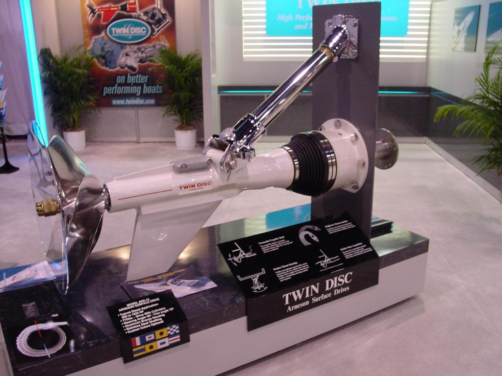

inline arnesons.....
Attached Thumbnails crash/standoff boxes ?-asd14.jpg   crash/standoff boxes ?-dsc01881.jpg   crash/standoff boxes ?-gmin.jpg
