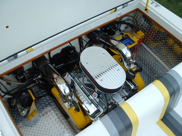

Been running this 383 since last spring.
Eagle forged stroker crank and 3D ESP rods.
JE pistons, 12.7:1
AFR 210cc heads, ferrea valves
Crane solid roller cam. 250/258 duration, .598/.598 lift on a 112
Victor Jr intake w/ 750 holley.
EMI exhaust w/ stainless tube risers.
around 560-570 hp
spin 6000 rpm.
runs on 110 octane
idles at 800 in gear
I don't shift it while its running, always start in gear. great through no wake zones no problems. the boat is for sale with motor.
