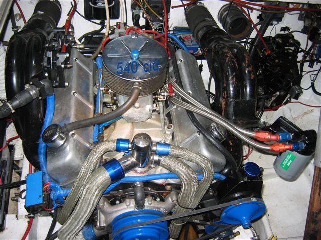

Here's a couple of pics. I don't know the brand of the header. They go straight out the back with no mufflers. What is a good head to use without spending TOO much money? Since I have to buy all new valves anyway and have one head that needs to be fixed, a head/cam/intake swap sounds like a good idea. Any advice on the perfect/affordable combo?

Those are lightning headers.....perfect and affordable do not go in the same sentence.
