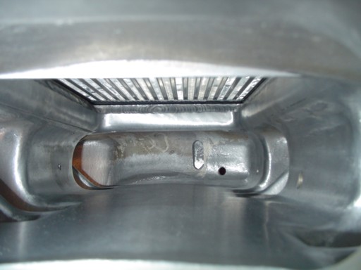

A word about these cross ram intakes and supercharging. Those long runners were designed to boost torque down low for getting on plane. In fact you may remember that the 502 MPI engine came out at the same time as the Blackhawk and the Merc engineer interview that I read said that the intake created an extra little torque peak at 1500 RPM just so that the two big surfacing props wouldn't stall the engine when you tried to get on plane.
So if you want the same "look" to the torque curve just higher values, you keep the manifold more or less as is and increase air density with the blower. But if you want a higher revving, peakier torque curve switch to a single plane Holley EFI intake. Jim Shofner told me once that such a switch was worth 80 HP. But it isn't hard to figure out what you would give up.
Shortening the runners in the MPI intake sounds like a good solution that splits the difference between the stock intake and the single plane. As far as the intake only being good to a certain HP level, I don't buy it if you can increase boost. Dying after a certain RPM level I believe.
Something else to think about. At WOT the air is just whistling through the throttle body into that intake. I have to think the momentum of that air favors some runners more than others. This makes the plenum's job of spreading the air around equally more difficult.
On the HP500EFI intake, which is similar, we block off the throttle body flange, and bring air into the plenum from the top through an intercooler. This is nice laminar, slow moving air brought into the center of the plenum. I think this has to help volumetric efficiency, but I have no back to back testing to prove it since we are adding a blower at the same time.
This is the resulting HP curve with stock heads and cam, and I don't see any choking effect of the intake. I would like to plot articfriends curve along side this one just to look at the shapes.
