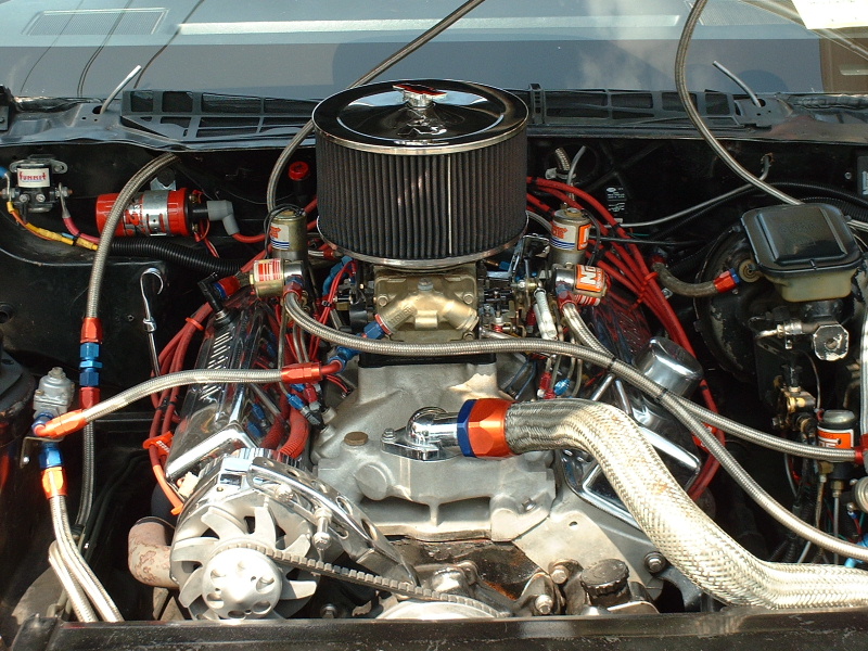

NOS sells a bung with nut, you drill a hole and insert the bung, nut from the bottom...1/8" pipe thread for the fogger. I would go with a seperate fuel pump and a dedicated fuel pressure regulator for tuning. Can you tap your tank for fuel?

Kinda what I've been saying, but answering the questions with my best opinion for his application!
Dave
Attached Thumbnails 496HO Adding Nitrous-engine.jpe
