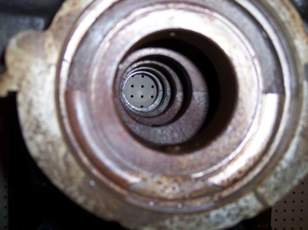

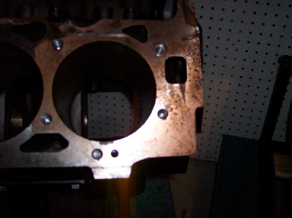

first pic shows rust left on deck area after going over with rag and WD40. Second, looking through mains also sprayed and wiped. Third is rust in cylinders, right deck has been gone over with scotch brite. What is that line or groove on the right deck, above the cylinders? It is present on both engines.

Bare metal, machined metal will tend to develop rust when humidity is present. Hot tanking the blocks should clean them up, hard to tell from the pictures some does look pretty bad. Have a builder look them over for you to determine the condition. Its possible the seller had them sitting packaged up and was unaware or the rust build-up???...

Im no expert by far, but I think your ok. After I had my block hot tank,it only took a day for rust to start to show up after it was exposed to moisture. Just make sure you get it all clean up prior to assembly. Im sure there are some pros on here that can tell if its ok or not. In the meantime just spray down w/ WD40 and keep them covered up. I used a large GLAD trash bag to put mine in.
