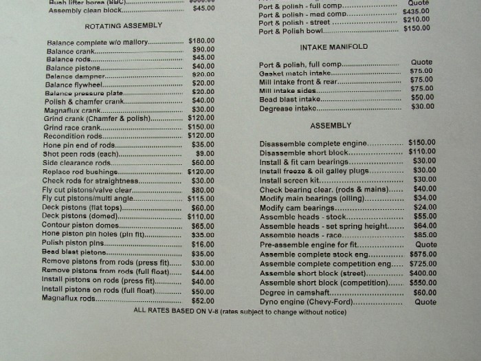

Spun a rod bearing and crank needs turned. While engine is out I may as well get the full rebuild. Guesstimate on short block rebuild cost? Just so I know my builder is in the ballpark.
Any thoughts on upgrading to Keith Black pistons? This is a blower motor application.

Here's a labor/machining price sheet based on $70 per hour labor rate from a local reputable machine shop that machines lots of engines destined for marine use. It lists all or most of the machining processes that your engine may need to under go for a rebuild. It should be in the ball park or at least give you a fair idea of what you should be spending for a rebuild by a reputable shop. (click to englarge photos)

I just finished three hp500s for a friends Fountain 42 and they were completely balanced and blue printed new arp rod bolts JE pistons reconditioned rods ground the cranks align honed the blocks parallel decked and bore and honed new cam bearings he got the cams and the new heads and had me assemble the heads and set the springs up the short blocks were $2500 machined and assembled each. Most importantly with the quality parts you need best of luck Laz

Laz ... am I reading this right ? you did the machine work & assembly ... supplied the rod bolts and pistons .. for 2500.00 ?
