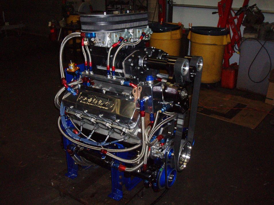

DO NOT LEAVE THE TAPE ON. to cut to length your hose use a shear. no grinding , no oil nada. start by cocking the female end on the hose . use a lil downward pressure then rotate. works every time. use a suitable lubricant, i chose never seize as to reduce galling of the aluminium to aluminium contact. and make sure you rinse the lines thoroughly.
heres a couple of hoses i had to make in sizes rangeing from -4 to -20.
good luck

monsta, are those craigs old mills?
