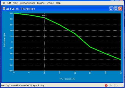

Dave, do you know if and how the absolute value of the TP Sensor voltage is used to adjust fuel delivery? I know that the MAP value and rpm are used as the main input to determine injector opening times. The absolute value of the TP sensor may be used for some further adjustment. Do you know how?
I found this one in another thread. Maybe it is not relevant?
